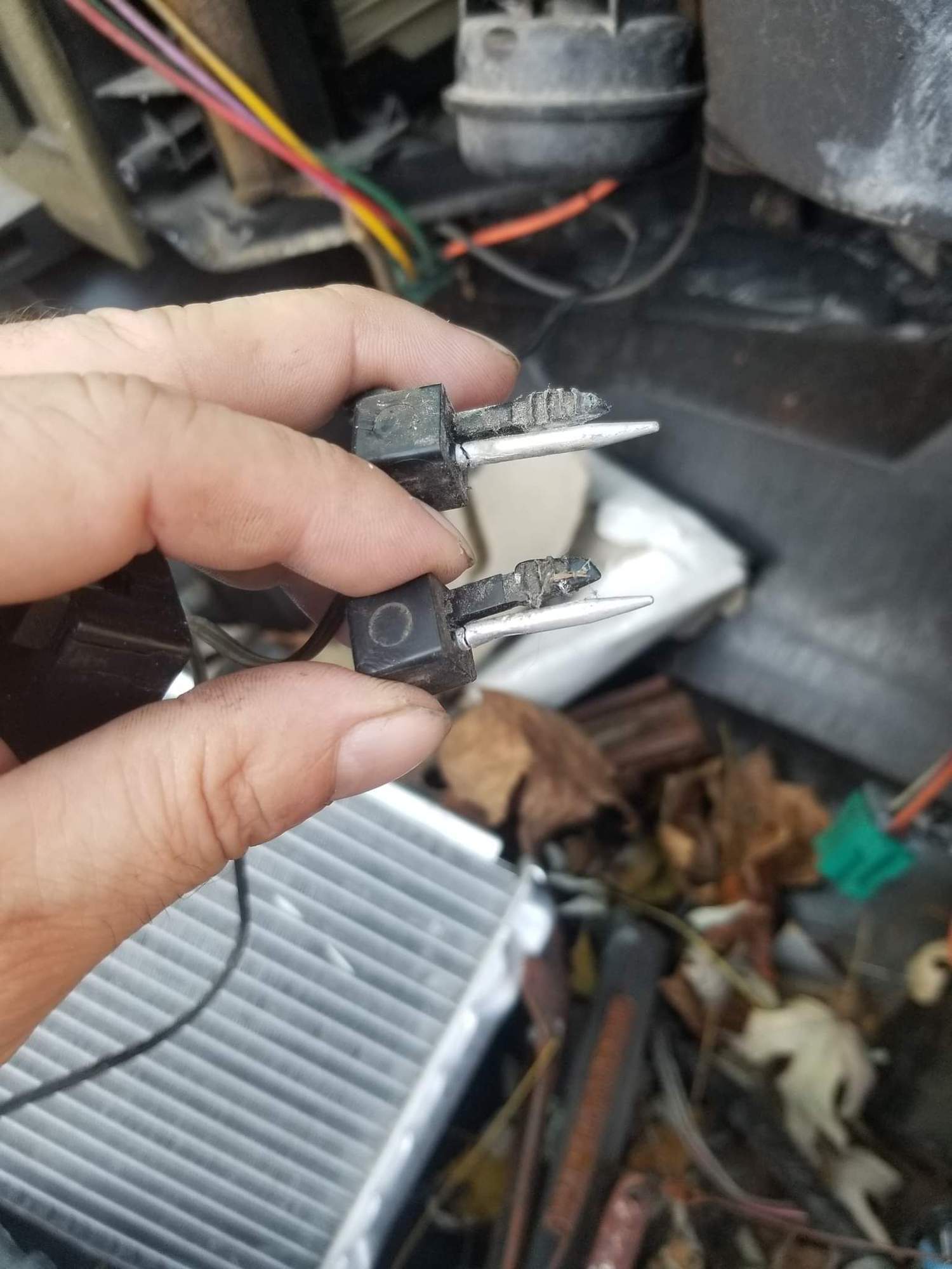

I have a gentleman that has a few he's parting out, 2 that he pulled were cracked right after the probe passes through the airbox (years of vibes most likely) and should've been installed with a grommet or RTV. Awful GM engineering.
Images he sent me. Still functional? Probably. But I'm hoping for a whole one.
