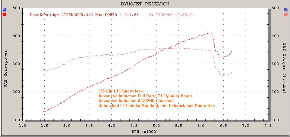

My car is doing something similar, but I dont have a supercharger. Cuts out at 6200-6300 and drops nearly 100 rwhp. Havent gotten to log anything yet, but so far nothing has helped.
http://www.advancedinduction.com/Dyn...ynoProbSAE.jpg
