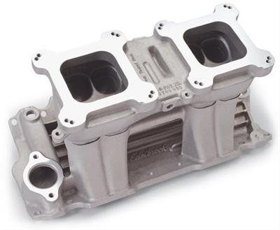

But you know. there's another option. It's more expensive, although not brutally expensive like forced induction.
It's also fallen out of favor, for some valid reasons.
But it's still a good idea and they make more torque than you would think they would. I've seen some surprising dyno flogs.
I'm talking about this.

that tunnel ram would be really cool, but it won't bolt up to my vortec heads. If you find time I wouldn't mind an overview of a test or too, especially if its against another manifold.
