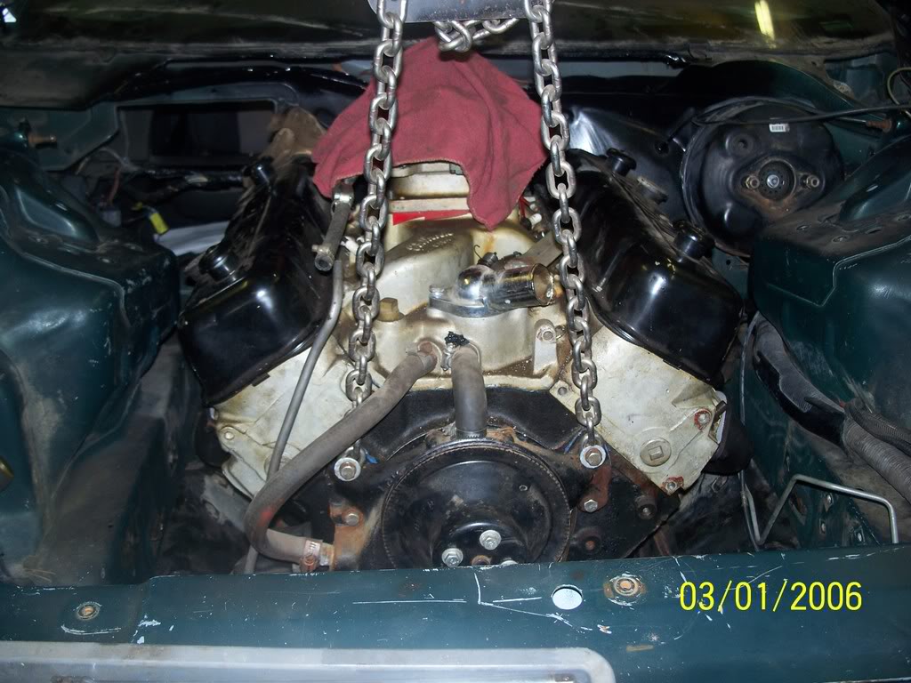

going to use the 6 cyl kmember for now
the center section weighed 15#
44# total 42.5# after cutting and welding
this will or should allow me to see what modifications I have to do to the firewall and side of the engine compartment. I'm dropping the rack 2" and tilting it back about 20*
where I wanted to set the engine hit the rack only
sorry for the small pictures I need another sight to host the pictures

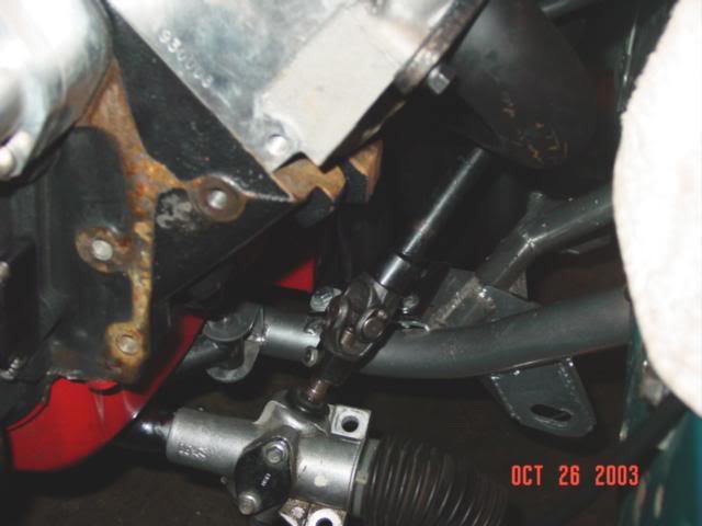

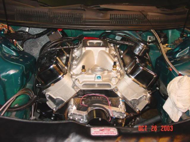

bbc pictures I have found on the net could be yours

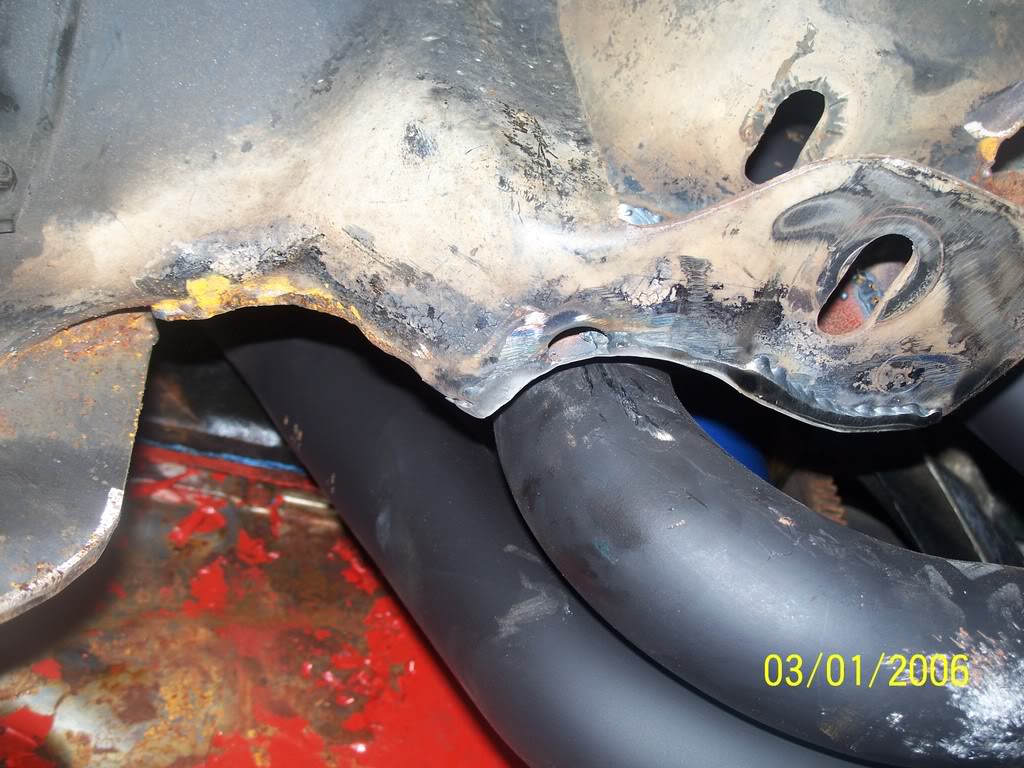

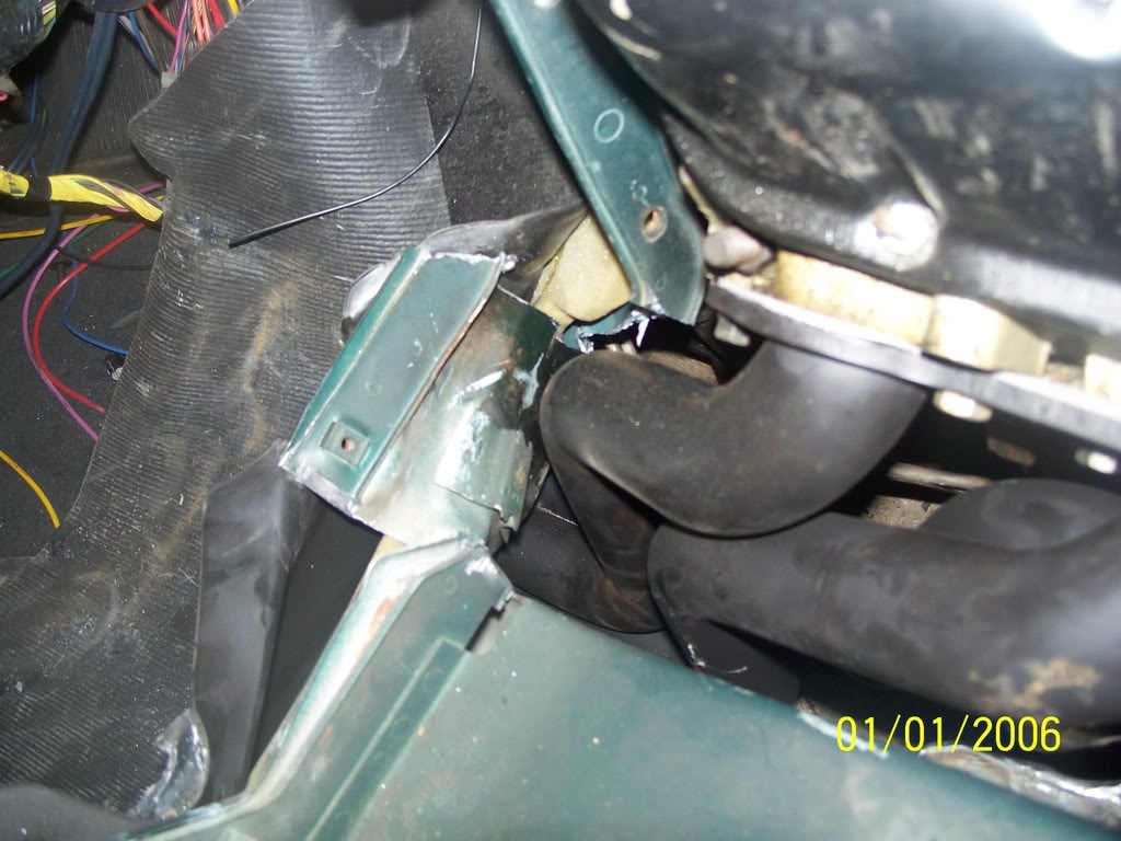

here's some of my junk before the batteries died

the fabrication is still on going, just trying to get everything to fit
the headers are on both sides , had to rework my kmember from the previous pictures, just about where my shoe is
