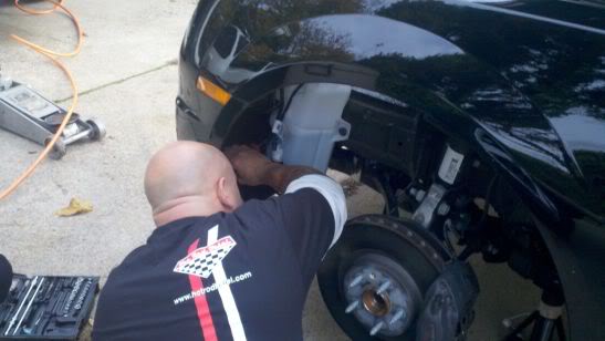

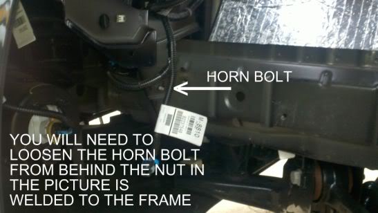

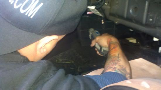

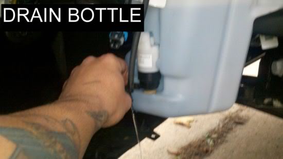

(WHEN I WENT TO TAKE OUT THE WASHER FLUID BOTTLE I COULDNT FIND ANY PICTURES ON HOW TO DO IT SO I HOPE THIS IS A HELP TO SOME PEOPLE. ) FROM NY5THGEN.COM

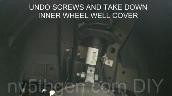

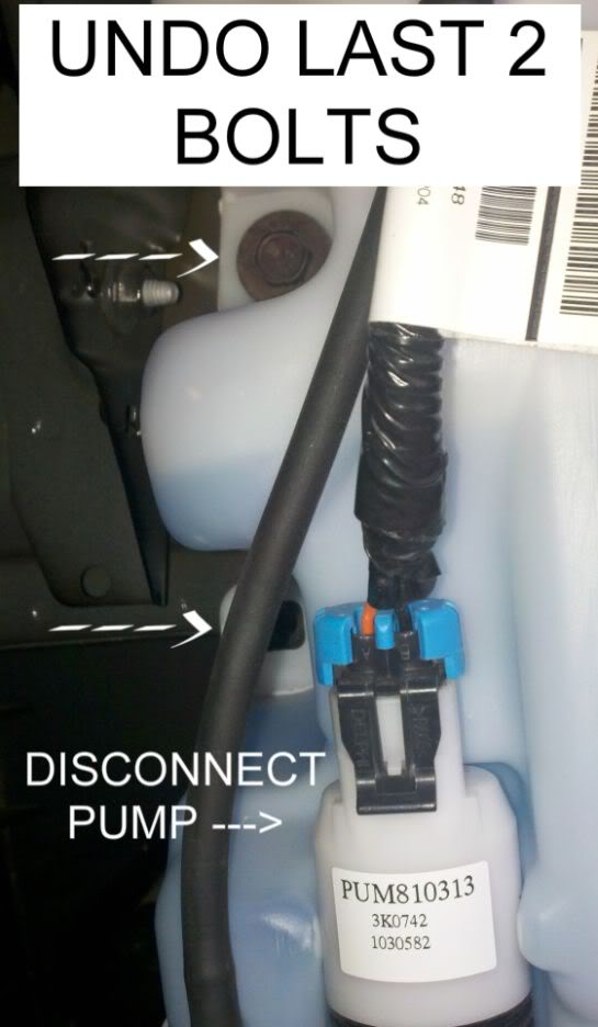

SAFELY JACK UP CAR SET IT ON A JACK STAND THEN TAKE OF THE TIRE
(100% FINANCED BY EBAY SALES )

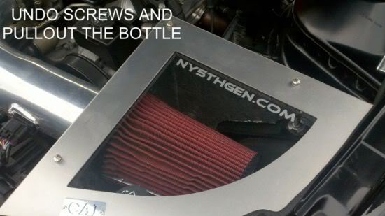

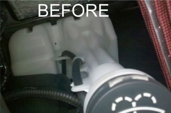

PART ONE WASHER BOTTLE REMOVAL

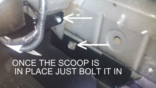

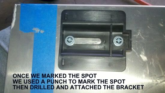

PART 2 INSTALLING THE AIR SCOOP
Size:  8.7 KBName:  BOTTLE2.jpg

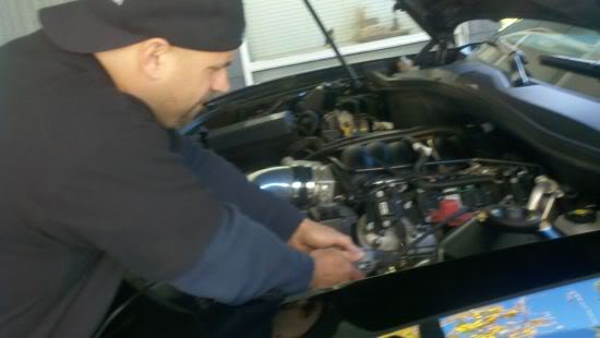

Old Jun 13, 2011 | 08:51 AM
Mucker15's Avatar
Joined: Dec 2005
Posts: 203
Re: Washer bottle removal and adm air scoop install

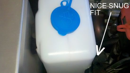

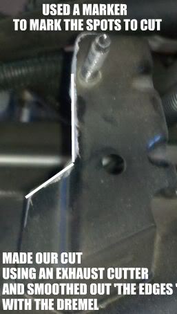

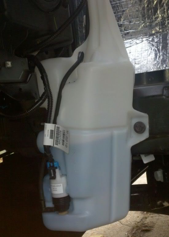

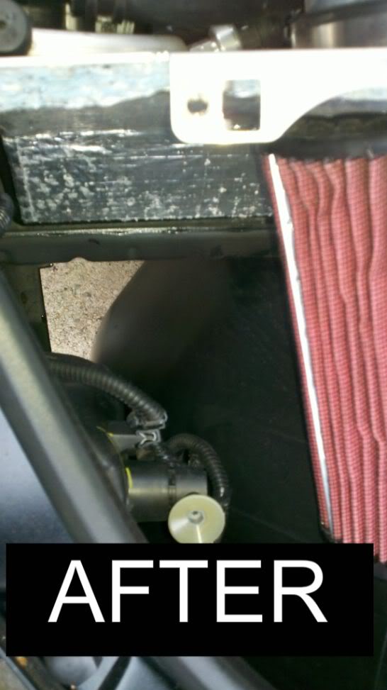

PART 3 RELOCATING THE WASHER FLUID BOTTLE

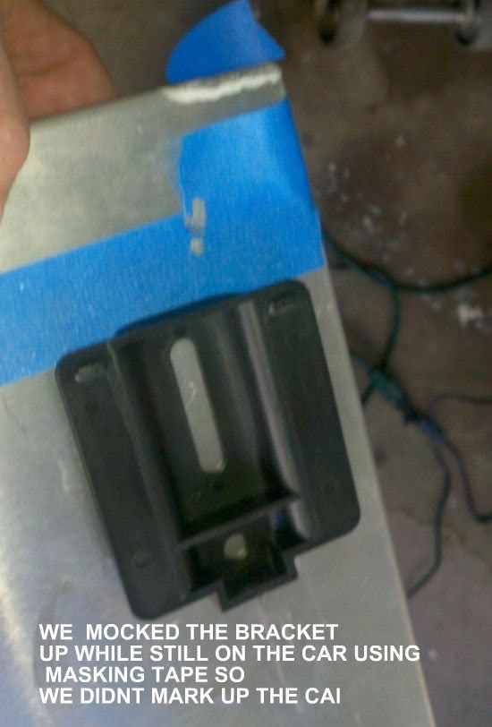

FIRST WE MOCKED UP WHERE WE COULD BEST FIT THE BOTTLE,
(WHILE WE HAD THE WHEEL OFF WE WIRED THE NEW PUMP INTO THE STOCK WIRING)

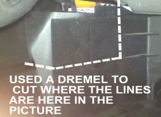

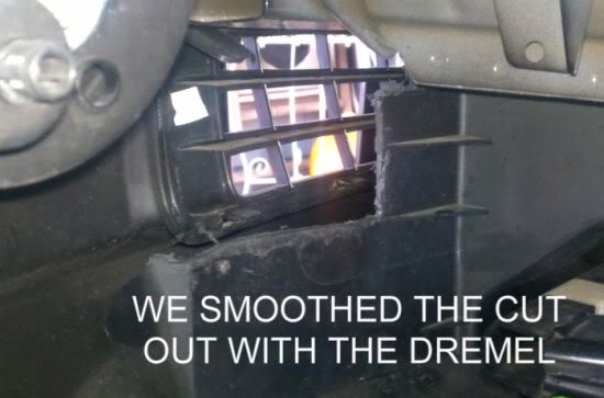

ONCE MOCKED UP WE EYEBALLED HOW MUCH TO CUT AND GRIND OUT OF THE ORIGNAL INTAKE MOUNT

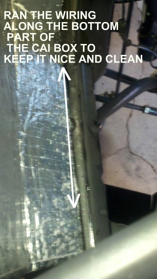

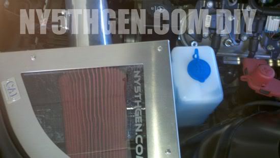

PUT CAI BACK TOGETHER
We had removed the washer bottle last week so I got to drive the car with out the bottle and no air scoop. I noticed a bump in performance this way. You can hear the air flowing more freely.
We added the air scoop and it made a big difference over the washer bottle delete. This is worth it no doubt. Car is faster than it was before and to me thats worth the money. Good mod for under $200.
ADM AIR SCOOP $75 (FREE SHIPPING CAN BE FOUND)
1.2 WASHER BOTTLE $ 39 (12$ expedited shipping)
total cost $126
TOTAL TIME INVOLVED 2 HOURS AND 45 MINUTES
