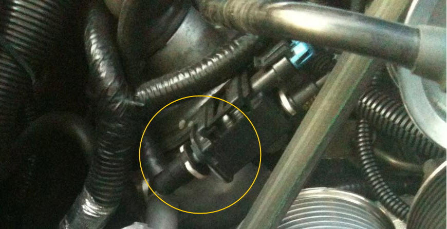

It comes from the solenoid that is attached to the passenger side cylinder head. I think solenoid is the correct word to use.
I have attached an image of the solenoid that I found online, with the area that is pretty thin and weak that I accidentally broke circled. All it takes is a tug on the hose and it could snap the thin part of it. I tried fixing it with JBweld as I had a car show to go to the next morning, but I am told that all it takes is a pinhole to throw an error code.
Take a look at yours when you can and you will see what I am talking about. I can upload a better pic tonight when I get home.

No, light gray plastic. I was removing the hose and gave it a pull and it snapped. It was around 4am. When you look at yours, you will see a really thin tubular part just above the part that the bottom of the hose is attached to...it broke there.
I fixed it by just replacing the entire unit...30 bucks or so at the dealership. Now I just need to clear the error code that driving with the the "fixed" one.
I'll get a better pic tonight.

I found a couple more pics of the entire unit online.
Where is broke was right between the plastic collar and where it tapers down on h gray part.
