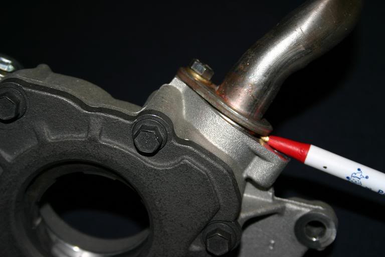

just checked with the parts dept, the 2010 camaro is in the gm parts catalog, dont know how long its been up, so i ordered a pan and pickup tube
and guess what, its all the same part numbers as the 2009 pontiac g8 gt
i also ordered a BRPhotrods oil pickup tube girdle:

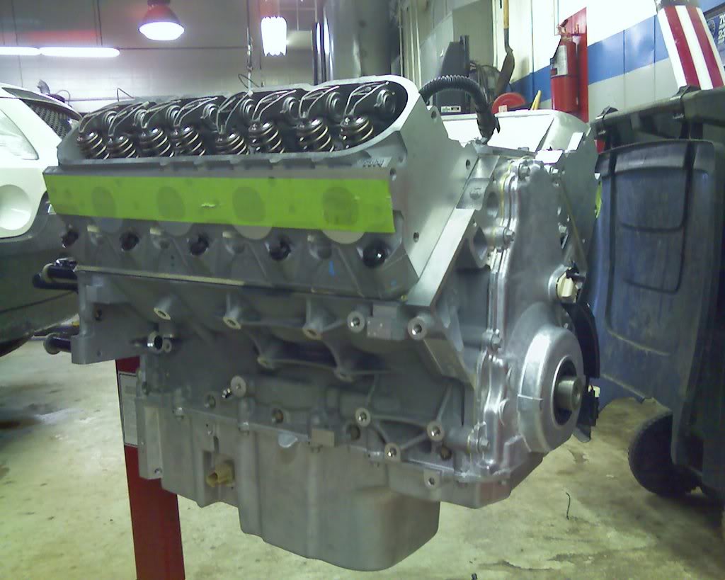

got the correct camaro oil pan installed and the front cover, engine has been pre-lubed/pressurized with oil

wow, so now its just a matter of waiting on your car to get there to swap everything over huh? can't wait to see what it does!
yup, just waiting, it will also get a yank 3000 converter and it will have longtube headers and x-pipe from a major header company that is using it for there test car
