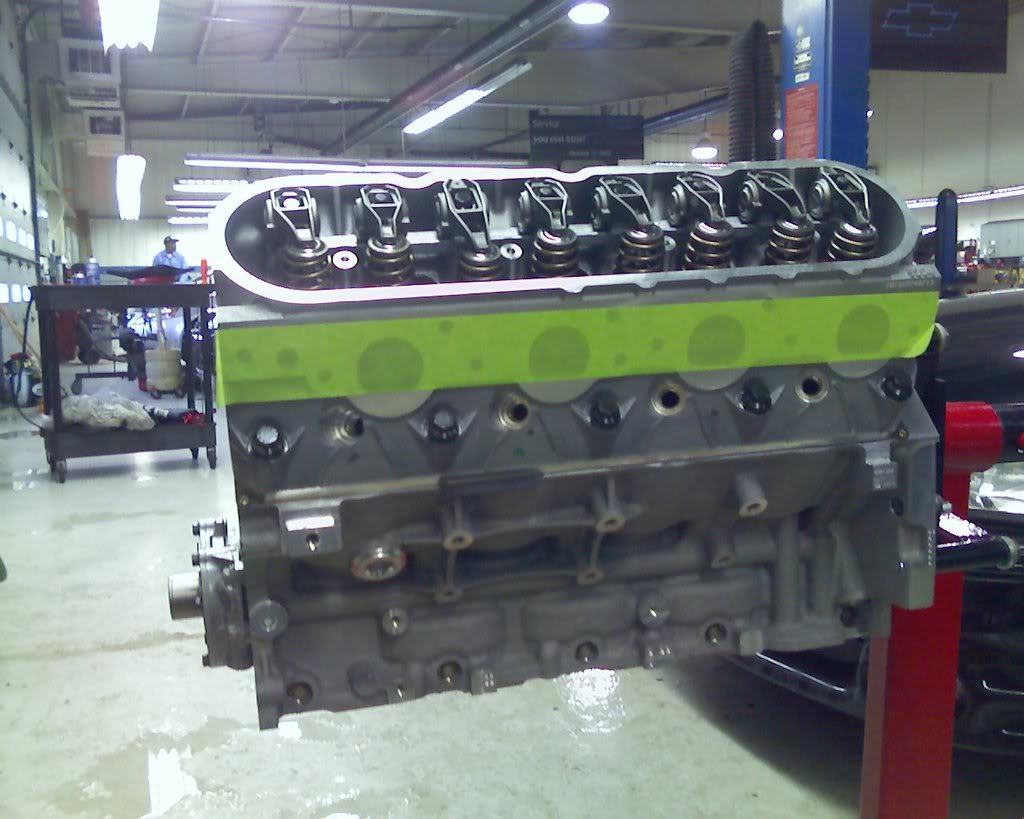

engine is done for the most part, just waiting for gm to get the camaro in the parts catalog so i can get the correct oil pan and pick-up tube, and i need to order my stall converter yet.
what kind of number do you think your going to be getting out of that?
over 550hp at the crank, i have talked to a couple vette guys with 415/416ci strokers like mine and they make around 500hp to the wheels behind a manual trans
Old Jan 7, 2009 | 12:17 PM
  #28
2010_5thgen's Avatar
Joined: Nov 2007
Posts: 4,482
From: ohio
so its a 415ci 6.8l? why not just build a 7.0 427 up? it sounds like the motor you built will be pretty bullet proof but why did you choose that motor? plan on doing a blower to it?
its a proven combo with no exotic parts, should be very reliable, i could have went with a 4.1" stroke crank and got a few more cubes but then any power adder would not be recomended because the piston gets a little thin on top,, so i went with a 4" stroke and a good forged piston so i can spray it at the track
also my s-10 went 10.50's in the 1/4 with just a junkyard 6.0L and unported L92 heads and a small shot, so this engine will be way better than the 6.0L i had,, should be fun, even though the camaro will be about 700# heavier than the s-10 was
