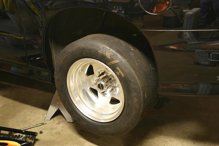

I have 26-11.5 15s on mine the 28 inch hight you will have to roll the fender lip and the 13.5 width you will have to do the BFH mod to teh inner fenders, you will have to cut out the bump stops, I have my rear narrowed 2 inches a side 4 inches over all, Im running 15x10 with 5 inch backspacing and I have plunty of room with my tires, Ive seen people fit those tires on there but its tight and you will have to have everything set up just right, heres some pics of mine
EDIT, I forgot to moser will only narrow a rear up to 2 3/4 a side if you go any more than that the brakes will be into the panhard mount

theres a guy on fbody.com that has them he narrowed his 2 inches like I did and runs 5.5 backspacing, they will fit but you have to do some beating to the fenders and roll the lip it will take some work. what for power do you plan to make that you need that big of a tire? if you dont have the power to turn them the extra meat there and weight will just slow you down.
