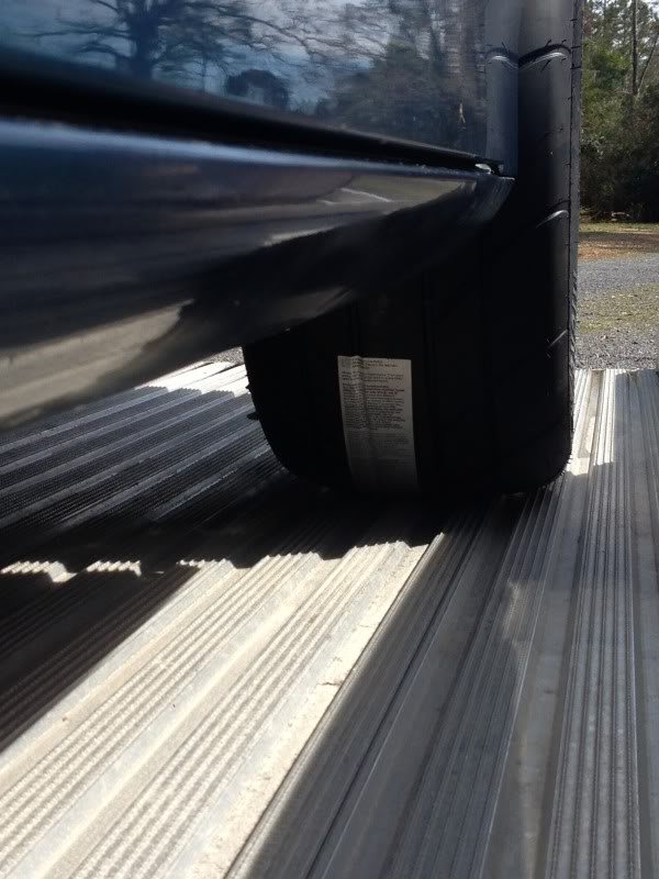

MT DR's heat them up a lil no traction problem at the track! No 275 have to small of a sidewall to take the intial hit out of the launch
295/50/16's

With just the HOT cam, and even with an upgrade to a larger cam and ported heads, I don't think he needs a 27.7" tire. His A4 is not going to hit the tires as hard as your M6.
