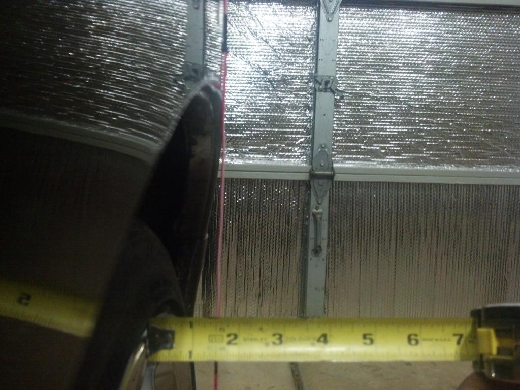

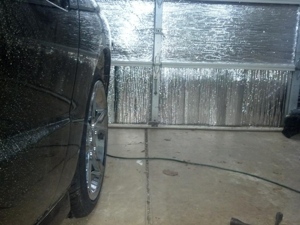

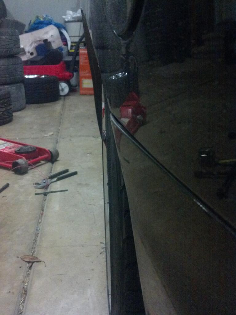

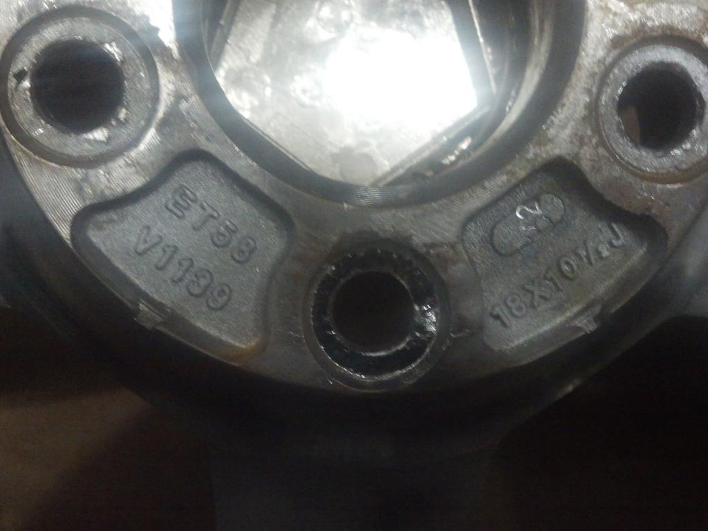

okay, I jacked up the rear end and kept the suspension loaded and installed the 18x10.5 wheel. It fits when the car is at ride level. Here are some pics. looks like its 58mm offset and 10.5 wide. The fronts are 56mm and 9.5 wide.
well with 3 hands the tape measure would be level, but I measure 1.5" to the edge of the fender.

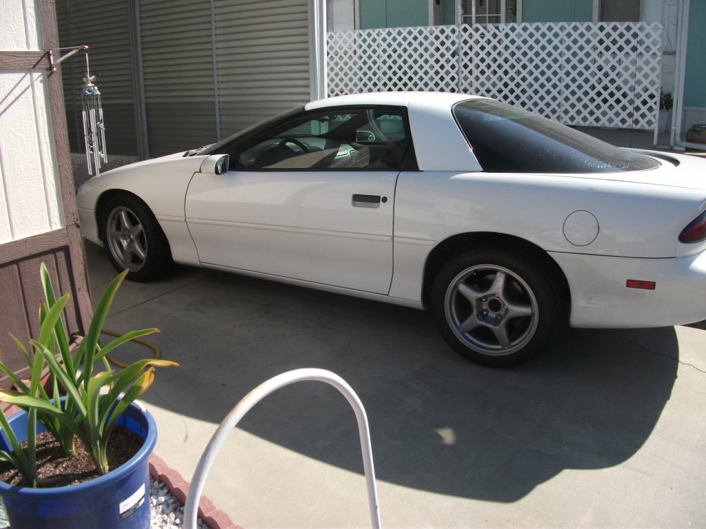

Old Dec 11, 2012 | 09:22 PM
Jeffs1997's Avatar
Joined: Nov 2012
Posts: 111
Re: Reproduction offset question C6 on 4th gen
here is my 97 with 50mm offset front and rear.

Posts: 71,099
Originally Posted by maybe2fast
hmmmm. I bought a 5/16in universal spacer and the wheel fit, but the studs were to short to use them. I figured since everyone in the C6 wheels thread said use 1.25 spacer that was what would get them flush.
I am going to measure and take a few pics of the wheel on the car, even thought its interfered with.
The factory C6 wheels, the one's shown in the C6 wheels on a 4th Gen "sticky", are 19 x 10.0" with a 79mm offset. That works out to a 8.6" backspace. They 1.25" spacer is larger than required to provide the clearance between the inside edge of the tire and the inner fender. 0.75" would provide the clearance. The additional 1/2" thickness moves the 10" wheel into the center of the wheel well, so it doesn't sit too deep in the well.
You need longer wheel studs if you are going to use a 5/16" spacer. That size spacer may move them far enough toward the outside to allow the outer edge of the tire to rub on the fender lip when the suspension compresses. I would think 1/8" spacer is all you need, but measure the clearance. You might have enough threads on the stud with 1/8". You need to have 12mm (a shade under 1/2") of threads engaged in the hex portion of the lug nut. The stud does not have to stick out of the end of the nut.
The reason they interfered with the suspension dropped when the car was jacked is the edge of the jounce bumper bracket hitting the rim/tire. That outer edge can be cut off. See my photos in the FAQ under the 17x11" wheel mounting post.
