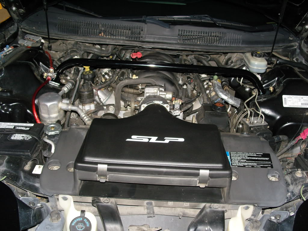

So I found out why the hell the rubbing was so loud even though I only saw minor rubbing on the plastic fender; the tire pushed the plastic fender inward a bit and it was rubbing against the steering knuckle!
Firewall is to your right in this picture as you look down the engine bay. Follow the knuckle and there you'll see a dark spot on the plastic, that's the plastic fender! Guess I should take them out if I plan on keeping these rims.
