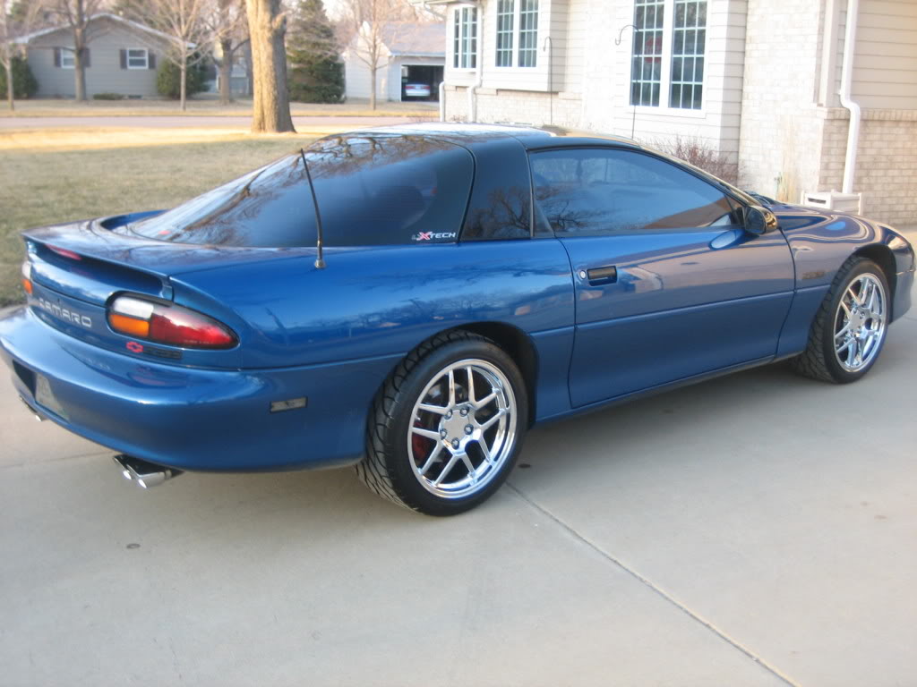

I just put 295/35/18's on my car this past weekend and it took some grinding of the bump stop for when ya jack it up and the suspension drops, otherwise it would have gouged my rim pretty good.......also took a lil BFH but not to bad just mainly down towards the lower front of the wheel well
here's some pics......hope they help!!

in the last pic u can see kinda how they fill out the wheel well and i did not have to roll the fender lip
LOOKS GREAT
