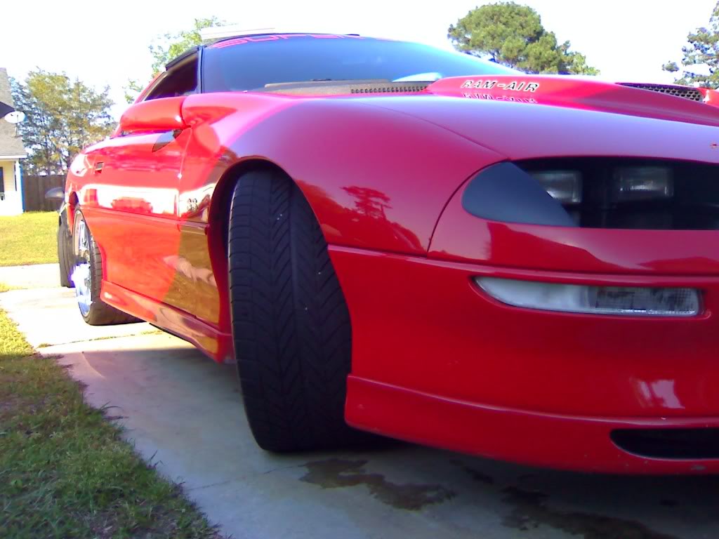

20x10.5's 295/25ZR20 Michelin Pilot Sport PS2's
Had 285/30ZR20's in the back, and moved them to the front when i got the PS2's

Did you have to roll your fender lip or did you just cut it. Do you think it is possible to go 315-335 in the rear with a set of 20" wheels. How much room do you still have in the well.
Old Apr 12, 2009 | 08:17 PM
jer4251's Avatar
Joined: Mar 2002
Posts: 1,191
From: Richmond Hill, GA
I had 335's on my 17's and had to do a good bit of work to get them to fit. I didnt touch the fender lips, but did completely remove the bumpstops. I had to make custom bumpstops farther under the car. and the 335's rubbed on my stock lower control arms. and under full load they would hit the fender lips when i didnt have bumpstops at all.
But i do still have room to go wider. 305 for sure. maybe a 315. the 25 series is what is giving me a little more room. the 35 series on the 335 was a tall sidewall. the 295s fit good tho. dont really see the need to go wider. if your going to be racing, i wouldnt suggest usng 20"s
the 295/25ZR20 pilot sport PS2's are just over $400 each. just something to think about
