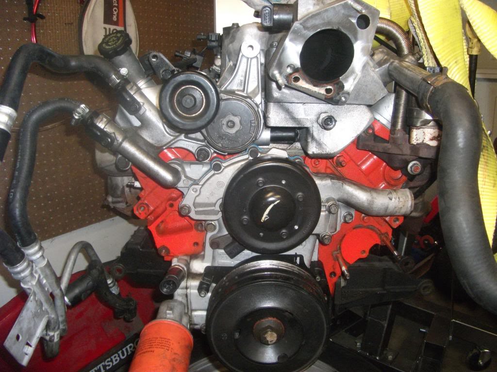

pulled 3.8 and found cracked block plus greyish oil oozing out of the rear main seal.
here is the crack ... it disappears behind the starter then I can't see where it goes.

Found this 96 firebird 3.8 for 700.00 as pictured on ebay, I heard it run in the car, it wasn't pressure washed this is the way it came out of the 96 firebird.
Looks like it was rebuilt then the car was crashed. It is very clean.

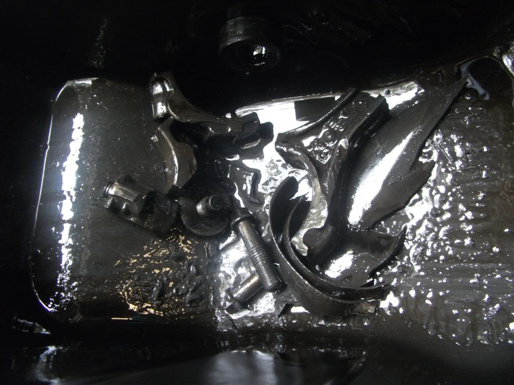

Here is the damage to the old 3.8
Pieces of connecting rod and bearings broken up in oil pan. Looks like one rod bolt snapped and the other threaded itself out.

History known, prior owner said it blew head gaskets, heads were rebuilt and new head and intake gaskets installed. After he got it back from shop it started making the knocking noise. I think it was hydro-locked at some point, why one rod bolt looks like it just threaded out and the other snapped I have no idea.
No the motor was never given any juice or turbo'ed.
No further dismantling of motor will be done.
