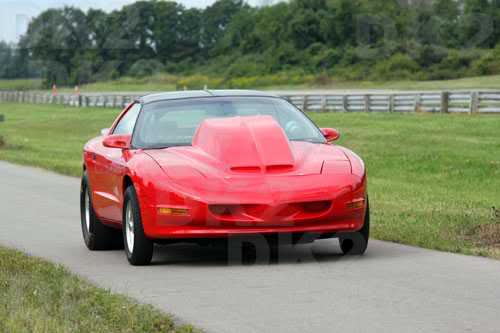

well its been a long 2 years building a new motor combination, and a car. laid off from 2 jobs, and on unemployment alot. but its finally finished.
i got a 96 firebird, 421 cu in, th400, moser 9", stock suspension, full interior car. motor dynoed 761 hp and 619 ft lb. first pass in the car went 10.44 @ 134 ( first time driving it) and now have 6 passes on the combo, got it down to 10.009 @136
should have the spray hooked up soon...

nice ride , she should be in the mid 9's with spray , how big of a shot u gonna run

thanks. it will be in the 9's on motor the next trip to the track, still tuning some bugs out of her. but I have 2 kits on the car. not sure on how much Im gonna spray yet.

That's one mean motor. Are you running a stalled auto or manual and what type of rear end are you running? Nice car; not what I would use as a daily driver tough.

thanks, I am running a th400 rev manual valve body with a 5000 stall. I have a moser bolt in 9" housing, full spool with 4.30 gears.

That is what I would say would get you the best times. Looks like you did it correctly. I am curious what it is going to run once you work all the bugs out and use the nos.

Looks like a $15-20k motor.
SB2?

your close on price.
but not a sb2, 12* wedge head

That's an awesome build. I bet it's a ton of fun. 8500-9000 rpm?
Most people don't realize that going from 600-650 horsepower to 750 horsepower on motor with an SBC nearly doubles the price of the build.

thanks, I actually only turn about 8000 rpms max, shift at 7600. and yeah the price on this engine was way higher than my last one. its a full nitrous engine, getting that much hp is pretty good. could have had a little over 800 if I went with a N/A max effort motor. still need a bigger intake, this one chokes it out some.

I took the car out again tonight. I havent touched anything on the car, and I made my first 9 second pass on the motor. boy that feels good.
