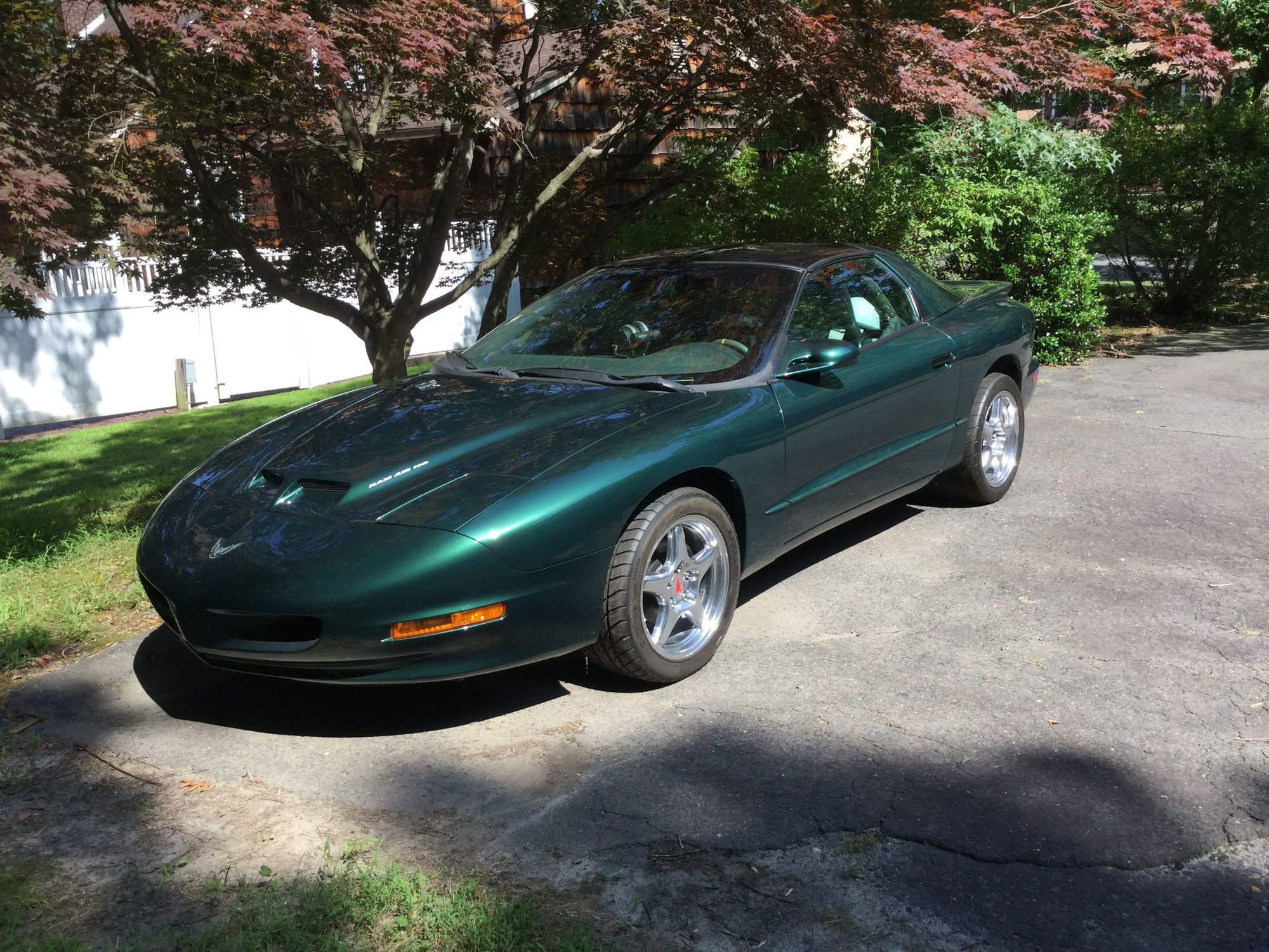

Do you want the rears spaced roughly the same as these:
The rears are 17”x11” 50mm offset. The “front space” is 4.0”. Your 17”x9” 50mm have a 3” front space. A 1” spacer would move them out to appear the same as above.
