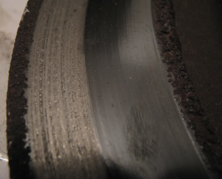

Other day I heard metal grinding sound comming off rear of driver side
Saw WORN off DISC and Used Pad.
I have replace the Disc and pad on both rears.
I notice driver side rear calipar was jammed and slidind rod was rusted Orange
I had to hammer out to undo the sliding bracket so I can re grease it.
However I notice some thing odd.
Driver side rear where bracket was worn out.
Passenger side had half of its life there. I have added following Pics
Can some body what could have cause all that ?

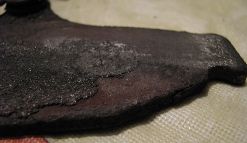

WORN out Driver rear Pad
Inside side of drive side Disc

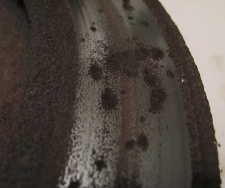

Outter side of the rotor

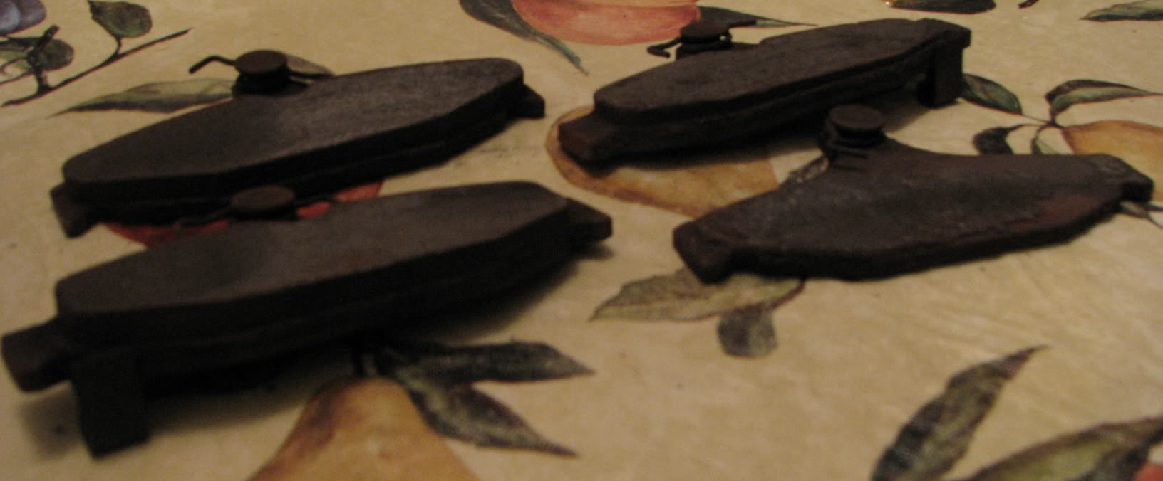

all the Pads including passenger side rear

Sounds like a stuck guide pin. You should replace it (if possible) or replace the whole caliper.
Yea that bone Dry and Rusted Orange.
I just relube it with Brake synthetic lithium grease and put it togather
Should I be worried
Old Sep 3, 2008 | 05:29 PM
shoebox's Avatar
Joined: Dec 1969
Posts: 27,727
From: Little Rock, AR
Keep an eye on it. It will do the same thing to the new pads, if not corrected.
