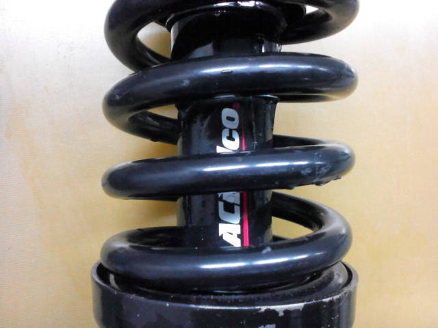

Before, drove 1,500 miles and 4,000 miles(((((

Looks good! You can't go wrong with the AC Delco stock shocks and I see Moog ball joints too so you are off on the right foot for sure.

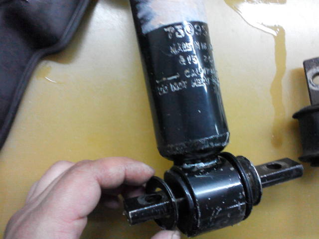

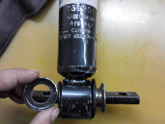

это Ac Delco развалилась (((, купленные на Rockauto

Wow, so they fell apart after short time!?

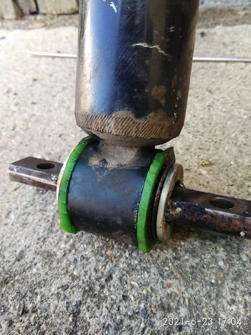

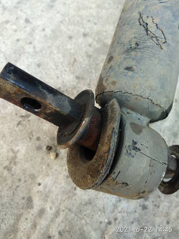

drove only 4,700 km, the tires squeezed out completely. the amlrtizers themselves are workers. put polyurethane from Mercedes Viano, I had to cut it. while it works.
