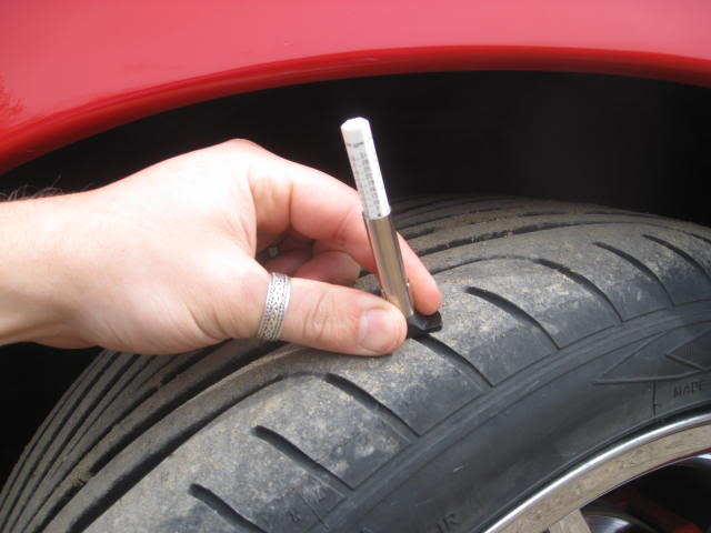

I checked tread depth, and the rears are at 9/32nds all the way acrossed the face. The fronts are at 9/32nds in the middle, and the outsides are at 5/32nds and the insides are at 6/32nds.
Anyways, looking at the car now, the outsides of the front tires are worn down more than the middle or the inside. The car tracks fine, but Im wondering if I need to adjust the alignment to specs other then stock. I have a built motor in it, with a Dana 60 and a viper conversion t-56... I drive it hard. I like to take corners fast as well... Is this why the front tires are wearing so quickly on the outsides??

Here is the outside measurement

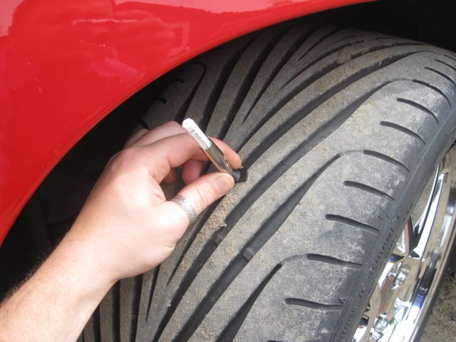

Here is the middle measurement

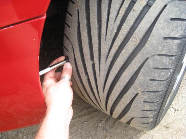

Here is the inside measurement
