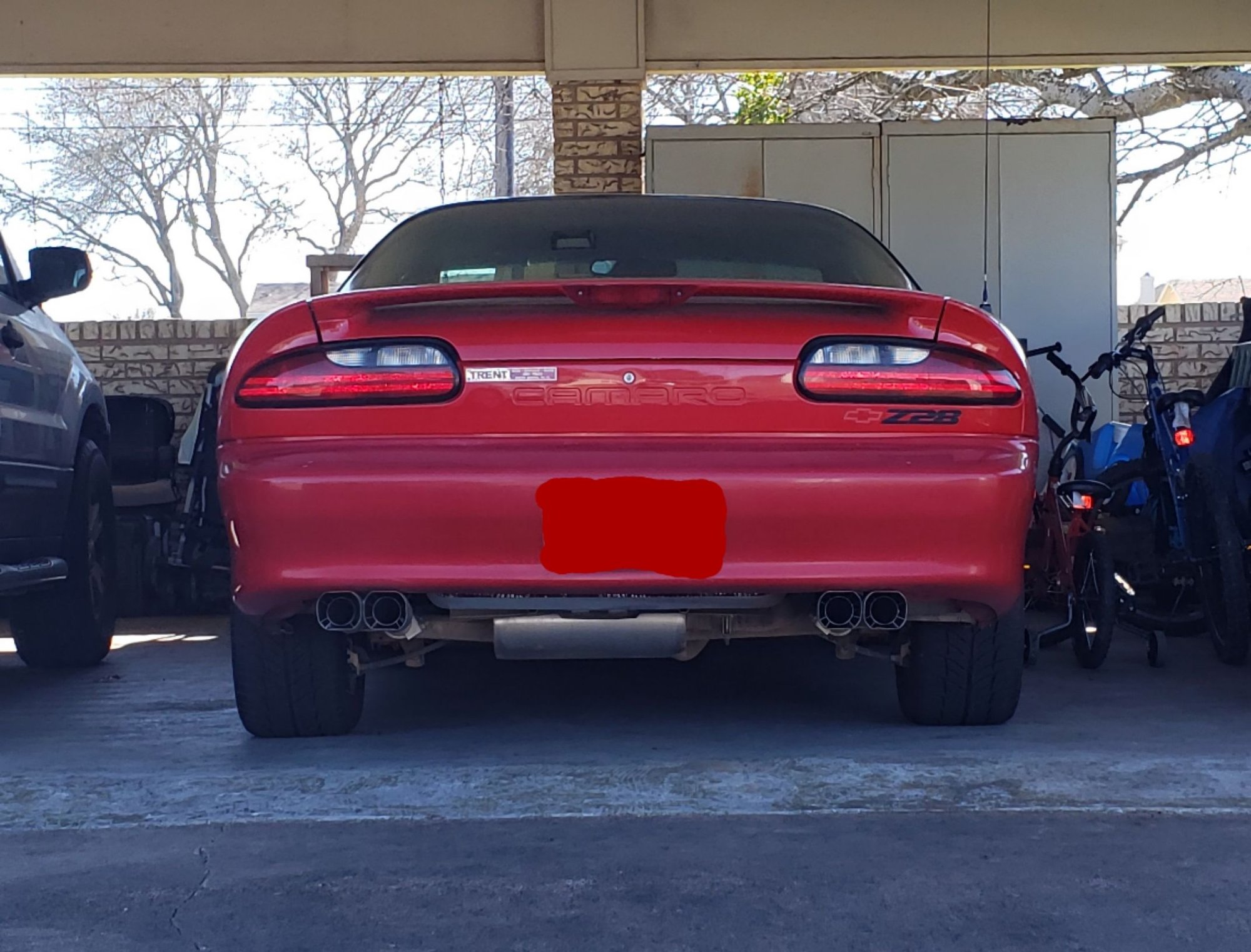

This is the slight lean to the right I'm seeing:

Is the sag most apparent in the rear view? Maybe the upper spring isolator is deteriorated (passenger side), or the spring coil is not indexed correctly into the isolator (driver side).
Yessir, it's only noticable from the rear. It appears that the passenger side front is the culprit, but that's only from visual inspection. When I replace the shocks, I'm also going to replace the rubber donuts (isolators?) that are on top of the springs in the rear...which I'll be lowering the rear end to do that.
