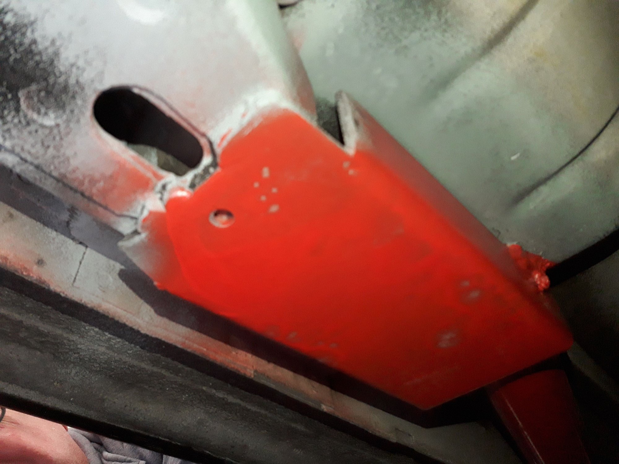

Done will take better pictures once on ramps and a report on handling.
weld is on side but hard to take a photo
Boxed area was not in full contact to body but new pic shows weld at other end
Weld is on both sides of hole

Have better shots of the installation, not overly happy with my welders efforts guess I will have to check them every now and then. But it seems to be strong at the moment and yes most of my rattles are gone. So that's a plus.
