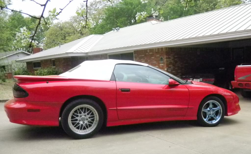

Put the '99 wheels on it and drove it around for about an hour, barely a single pull to either side, so it is the tires, about time for some new ones on the front anyway, but its pulled since these were new..
Here's was the mismatched looked...not quite the look I would be looking for...but I guess its kind of patriotic....red, white, and blue
