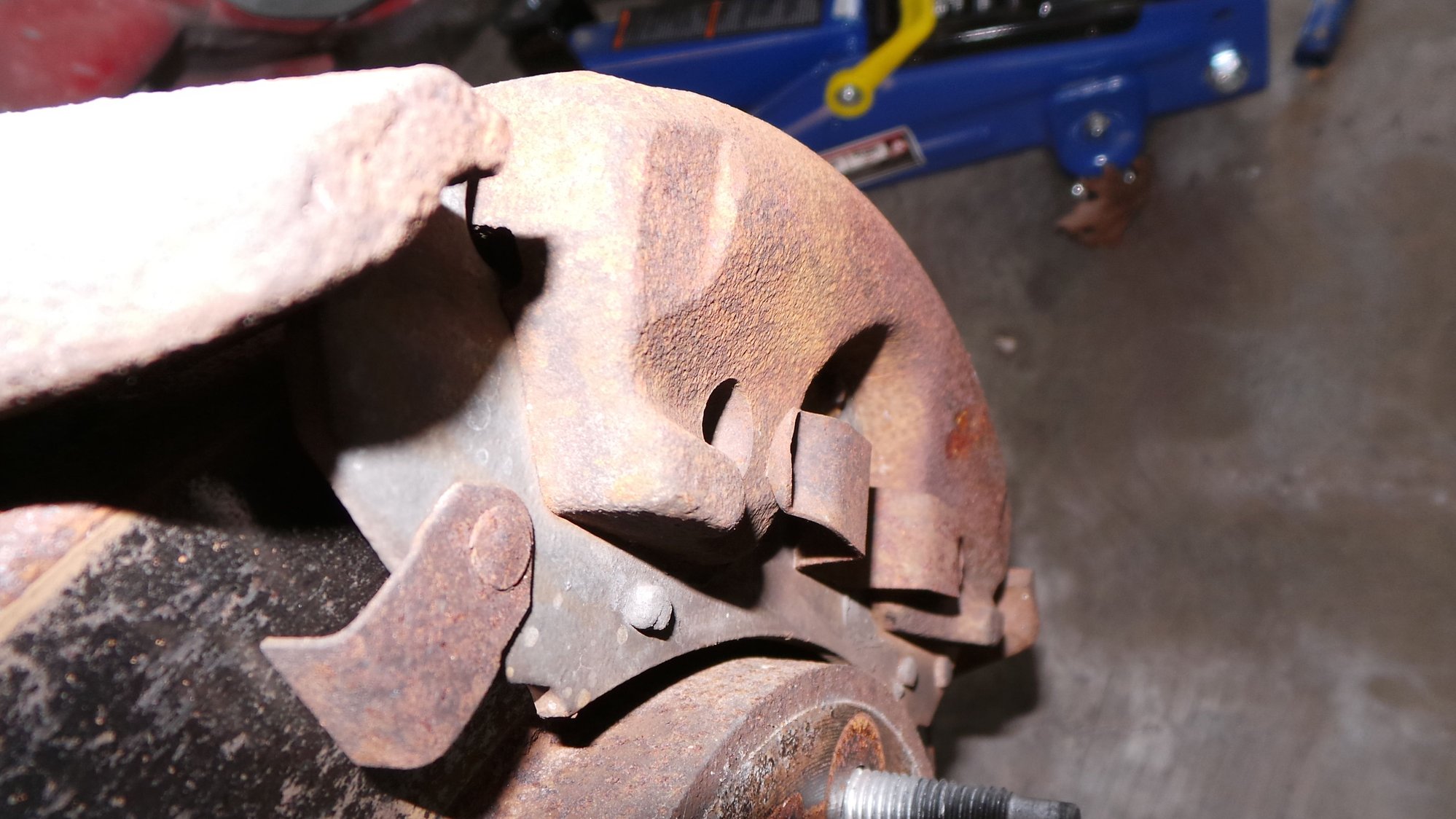

It's been sitting awhile and neglected. At 126K miles, I don't think turning them and new pads is a good idea. Here's some photos:
Most of the rotors look like this.
Yuck
Calipers look ok, could use some dressing up/repainting.

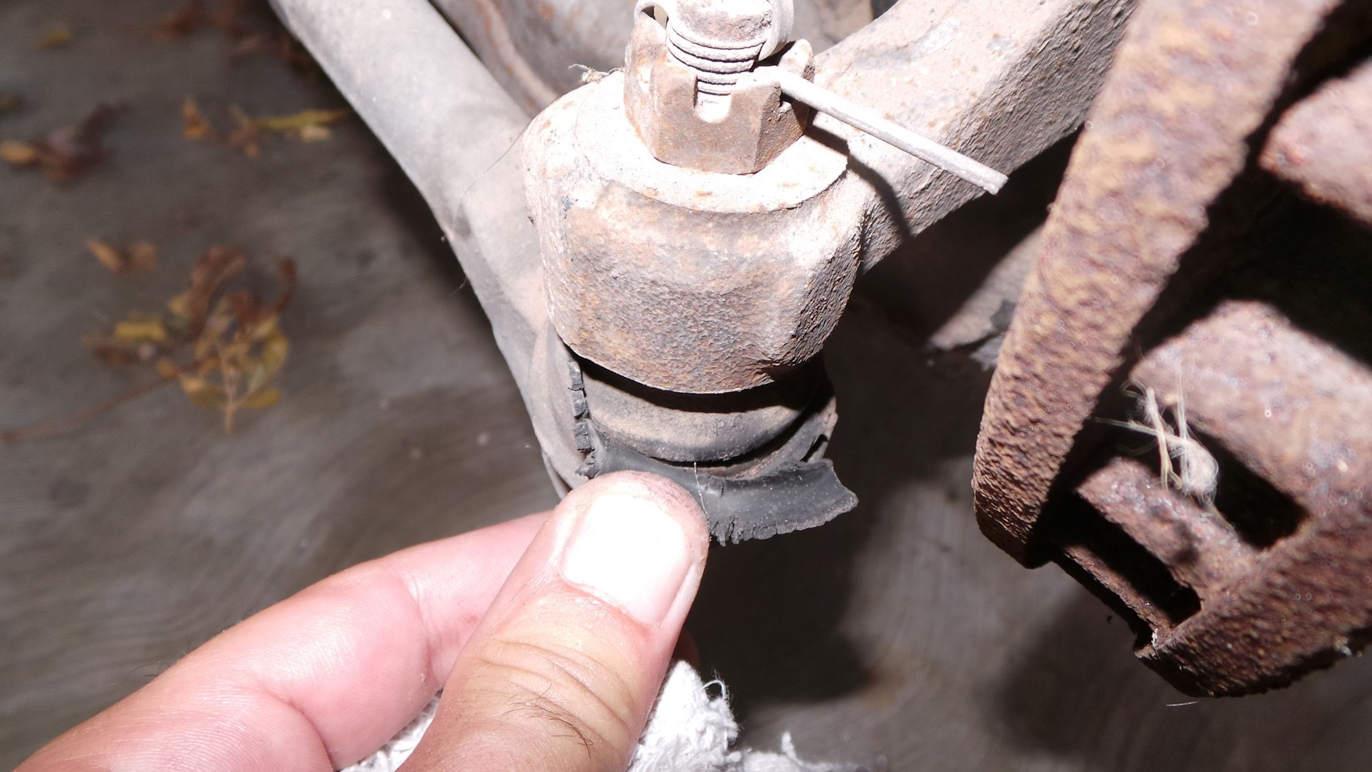

What ya'll think of this outer tie rod end? lol
Pads in bad shape.

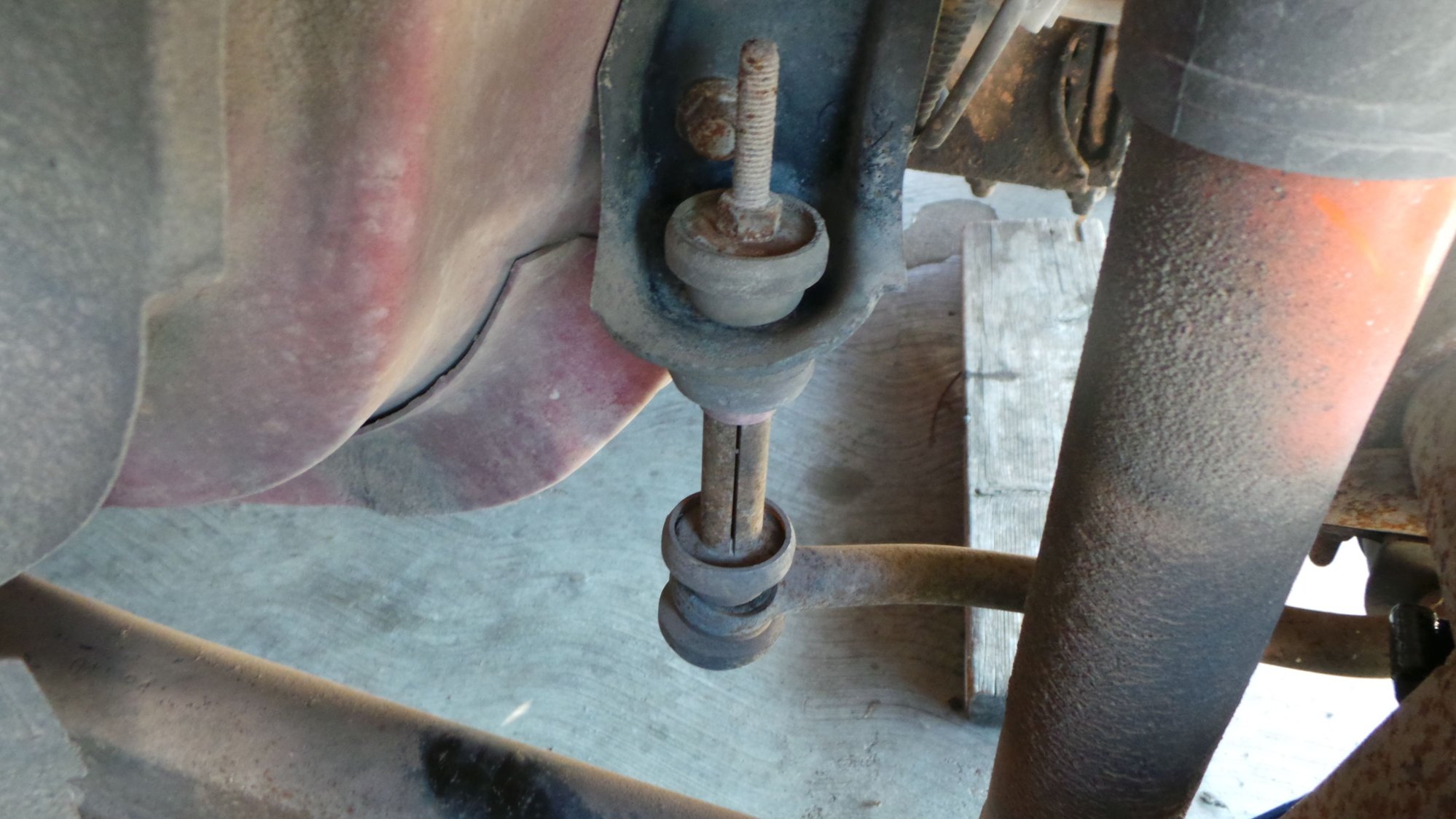

Rear sway bar bushings/links have seen better days lol
Is there supposed to be a stop on the bottom of the rear spring, or just the top rubber donut?

Looks like the car has lived in areas with salt on the road. Still lots of good solid steel there though! The springs just sit on the axle, no bushing. The upper rubber pieces are well made and are probably ok and may just need to be cleaned. Honestly the sway bar fittings look pretty good too, probably disassemble them and give them a cleaning. That is all I did on both my cars, clean and lubricate the fittings and bolts so they stop corroding. Looks like everything has been neglected and could be set right with some elbow grease.
I have had good luck with the stock rotors I get from NAPA, they are not expensive and work just fine. I am running Akibono pads on the front of my street car and they are very good and very clean. I have Hawk HPS pads on my track car and I like them very well but they are more dusty than the Akibono. I have Hawk HPS on the rear of both cars, they work well and they don't dust too bad because the rears don't work too hard anyway.

All what your seeing is surface rust. Car has never been in salt, being in TX most of its life. You're right though, underbody needs a good wash, maybe wire wheel/elbow grease when I've got it on jack stands.
Do you guys have a part number for those coated rotors for the stock wheel setup? I love my salad shooters lol.
