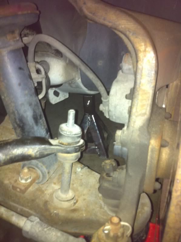

I finally got the time to dive into this. I'm on Step 13 of your guide, Injuneer. I need to grab a 3/8 Hex from my dad and locate a fork to separate the lower ball joint stud from the lower a arm.
Hopefully tomorrow night I'll find those then get the brake caliper and rotor off, lower the a-arm (after separating the stud) and slide the strut right out. The lower shock bolts are loosened in that picture.
I don't need to do anything with the tie rod ends, correct? Also, all of the upper shock bolts (in the engine bay) are off except one which is holding it in place.

how to remove strut, the way i do it and have done over 50 times
its easy, put your bottom back on lower ball join and pin not need to do it that way!!!
OK with sway bar bolts removed, lower 2 shock bolts out, and 3 of the 4 out strut mounts bolts out, pull upper ball joint pin out loosen the nut, then lower jack off the a arm just so its barely not touching the lower a arm then hit spindle hard hammer and it should pop off then jack back up and take the nut off the upper ball joint and the last strut bolt you left on off then lower jack and lower a arm and spindle should lower a lot and strut should and upper a arm should come right out. I do this never even removing the brakes no need to!
Thanks Dan.

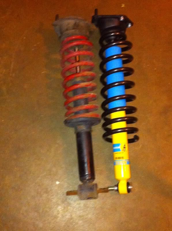

I'm slightly confused- what is going to support the bottom of the spring? and how you plan on attaching the bottom of the strut to the LCA?
Old Jul 27, 2010 | 11:32 PM
6SpdLT1Z's Avatar
Joined: Sep 2004
Posts: 2,595
From: Lenexa, KS
I haven't removed the hardware from the old strut or assembled the new one. Last pick was just a "mock up" before and after. It should bolt right up, it's the factory shock/spring combo for my car.

There's a hard rubber isolator on the bottom of the front springs that you will want to remove from the old units, unless you have new ones already.

I may be mistaken but judging by the bottom mount it looks like your using the rear shock for mock up.
