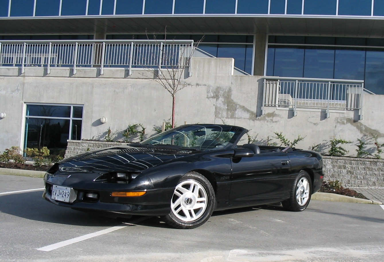

I have my 95 convertible lowered with a coil over kit in the front and adjustable spring kit in the rear, both from Ground Control. They make a kit for the Camaro that has Eibach springs and their proprietary coil over pieces to fit what ever shocks you have or are getting. The spring rates are chosen for a nicely aggressive balance of front to rear roll rate so the car really handles well.
You do have to be careful going over speed bumps and in and out of driveways but I don't mind and only scrape my catalytic converter occasionally!
Good luck!
ps TobyZ28 your car looks great!
Good luck!
