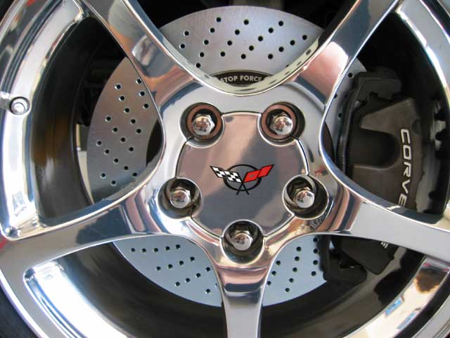

Powerslot rotors seem reasonably priced - you might look at those. I used Baers which were expensive, they are cross drilled and slotted and havent cracked, but I dont track the car. I use the HPS pads you mentioned, which stop well on the street and drag strop (from 127 mph) and there's no dust or bad wear to the rotors. I used C5 brake lines #22163727 in the front which are 1" longer but bolt right up with minor grinding of a couple small mounting tabs. Get some extra copper washers #10139097for the banjo bolts. I didnt do any brake MC or booster stuff to make it work.

Those rotors look killer! I just don't want to have to deal with something going wrong and they end up cracking on me. I don't want to keep throwing new rotors at the car.
