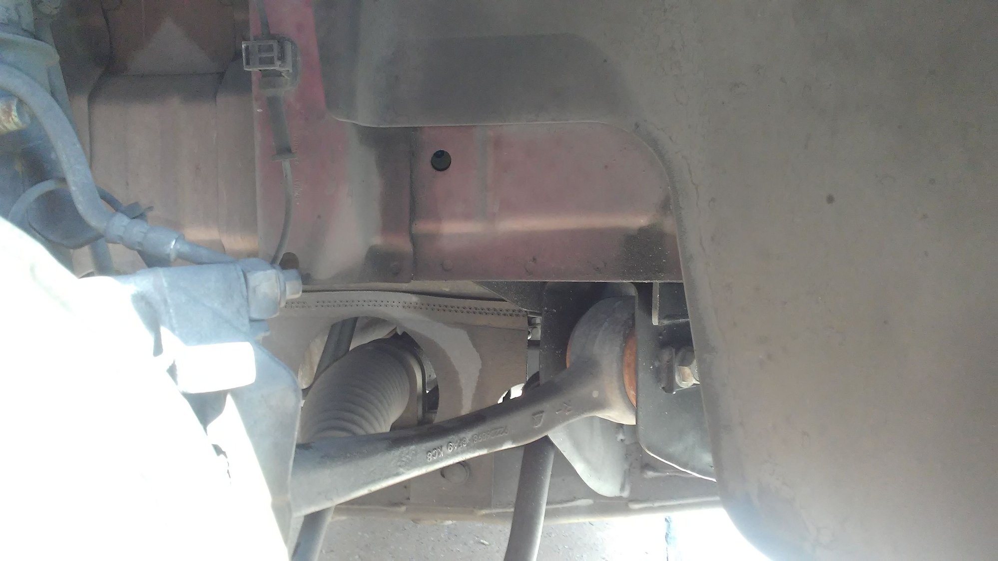

Hello I have the same issue, had balancing done 4 times and new set of tires and rims and front end check by tuffy but I didnt give up , have a friend 30yr mechanic found my problem and it is passenger front control arm, the bushing was shot, ORDER a new one will install on saturday. How we notice it , will we installed new rear slotted and drilled rotors and pads then installed in front and he found the problem The orange bushing on that control arm is shot, that causes the vibration. Will be replacing it.
