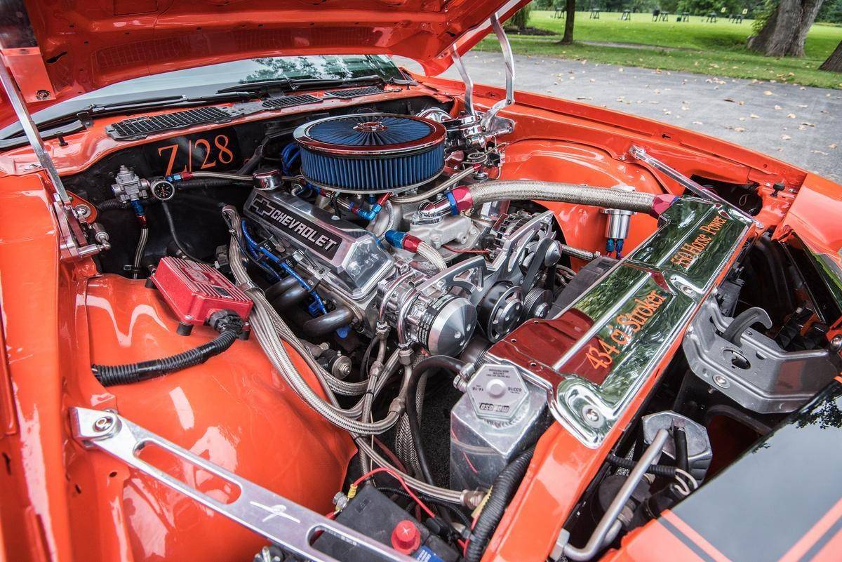

My power brakes are soft and I have no air in the line. 4 wheel disc brakes. My brake guy said I have a 50-50 balance in the master and I need 70-30 or 60-40. The motor is a 434 stroker and in a 71 Z28. What type master would be right. New to the forum. Thanks for your help.

As for the master cylinder bias, it’s not likely the cause of your soft pedal. The front-to-rear bias only matters for very hard braking. Do you drive this car on a track? Daily it in heavy traffic? By the looks of your photo, I’m guessing no. If I’m right, you’re mostly fine with 50/50.
