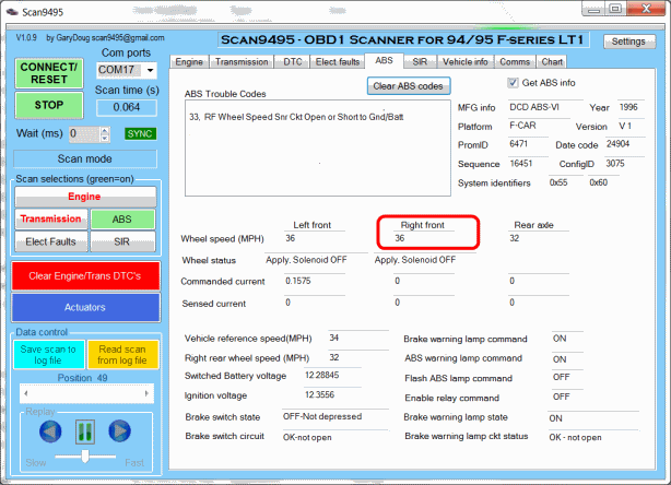

If you are using my app, Scan9495 or a Tech 1/2, you can monitor the wheel speed in real time. I would jack up the corner, remove the wheel, and watch the screen while moving around the cable and spinning the wheel hub at the same time. Might take two people. Watch for zero readings while it is spinning. The readings in this photo are not necessarily correct for normal operation.
Attached Thumbnails 94 Z28 Low Trac Flashes, then ABS Inop-abs-wheel-speed-check.png
