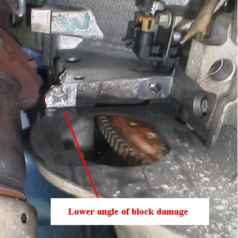

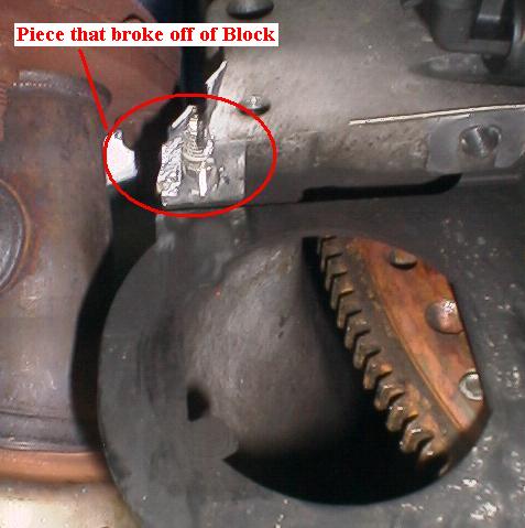

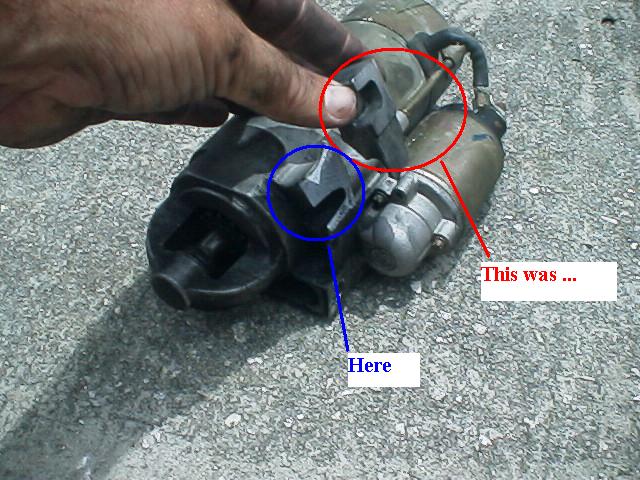

This time it's for a friend of mine's 99 Firehawk. He hydrolocked his motor on Monday night. Luckily He was idling with the clutch in. Unluckily he tried to restart it and messed up the starter.One side of the mating surface is busted off of the starter. A replacement is on the way. The worst part is that the outer portion of the mating surface sticking off of the block busted too. It split off right down the center of the bolt hole. I'll have pics later.
I figure if we can thread the bolt in to keep the teeth straight then weld the broken piece back on, we should then be able to run a tap into the hole and clean it up. It should be strong enough to work as long as he avoids those deep puddles in the future and doesn't try to start a hydrolocked motor.
Can you help us out. I know you said you would have been willing to help me out when I put a hole in my oil pan. I think the broken piece is far enough form everything that there shouldn't be any problems with melting plastic and wires or starting a fire.

I see, did the dealership question your FRA mod? That is my biggest concern about taking it to a dealer. If not, then I may just go ahead and try that. I found a welder to check out the starter mount hole on the block. So maybe it just needs the starter, an oil change and new spark plugs. Arg, please let me know how it worked out with the FRA. Thanks again

Here are some pics. (finally) You'll probably have to cut and paste.
http://2002.cz28.com/block%20damage%20low.JPG
http://2002.cz28.com/block%20damage.JPG
http://2002.cz28.com/starter%20damage.JPG
