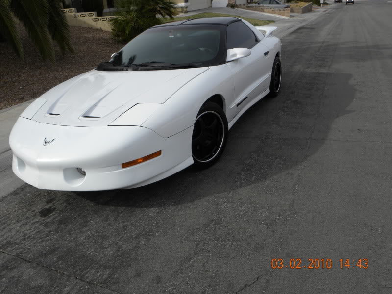

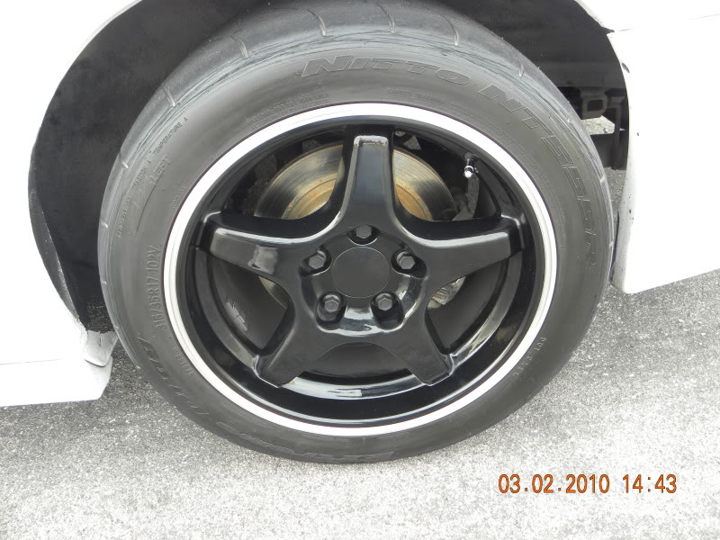

They fit fine but had to use the bfh for the 315s on the back what do you guys think

Old Mar 1, 2010 | 09:48 PM
felon_gt1's Avatar
Joined: Feb 2009
Posts: 90
From: tucson, AZ
looks real good man!
Old Mar 2, 2010 | 12:10 AM
69z-28's Avatar
Joined: Mar 2005
Posts: 1,349
From: chitown burbs
looks good but damn that Nitto is cut up! lol.
Old Mar 2, 2010 | 02:31 AM
Drew24's Avatar
Joined: Oct 2008
Posts: 300
Haha yeah they are used the guy had some fiting issues cause he lowered it but still has tread
