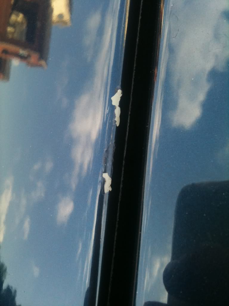

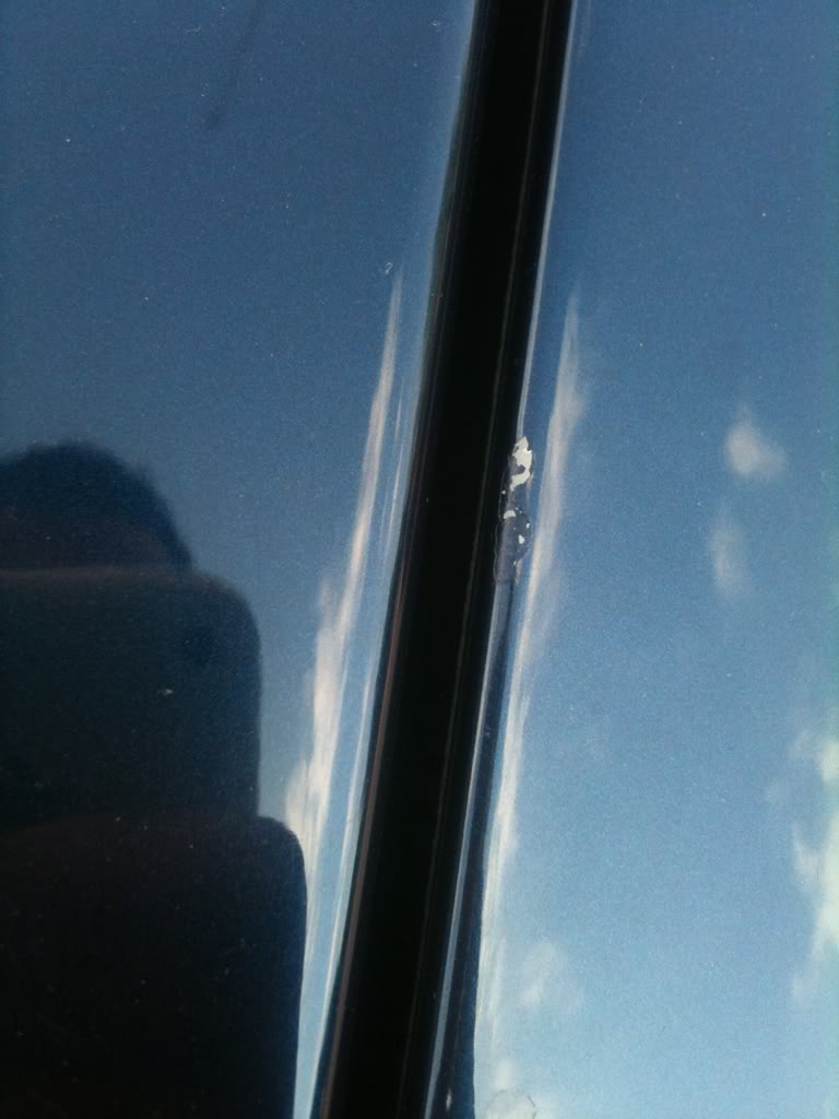

you cant completely fix the chips without respraying (from my experience). however, you can keep them from spreading, and if they are relatively small, make them almost invisible. get some clear coat 'touch up paint' (i used duplicolor), clean the immediate are very well, then put clearcoat over the chipped area, and maybe a 1/4" or less on the good paint. i had a ~1" sq chip on the front, i did that, and now you cant really tell from more than a few feet away

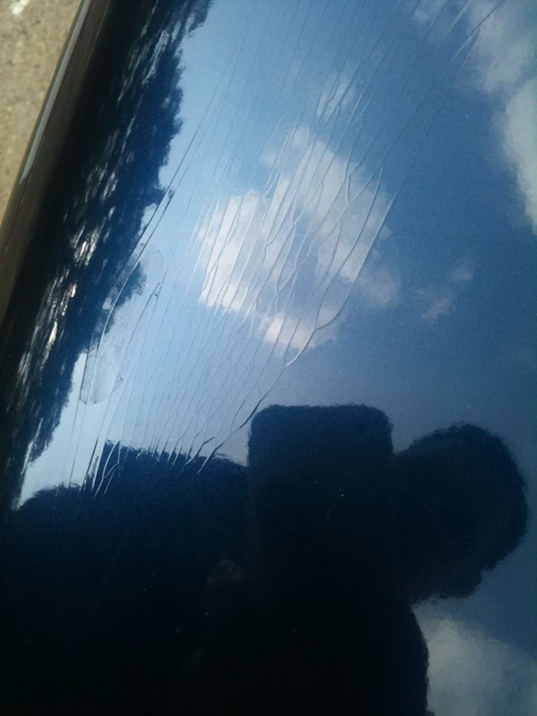

Re: Some Problems I noticed while washing my car(paint chipping and wood paint drops)
Photos
This is the passenger side of the trunk
driver's side of trunk
bumper

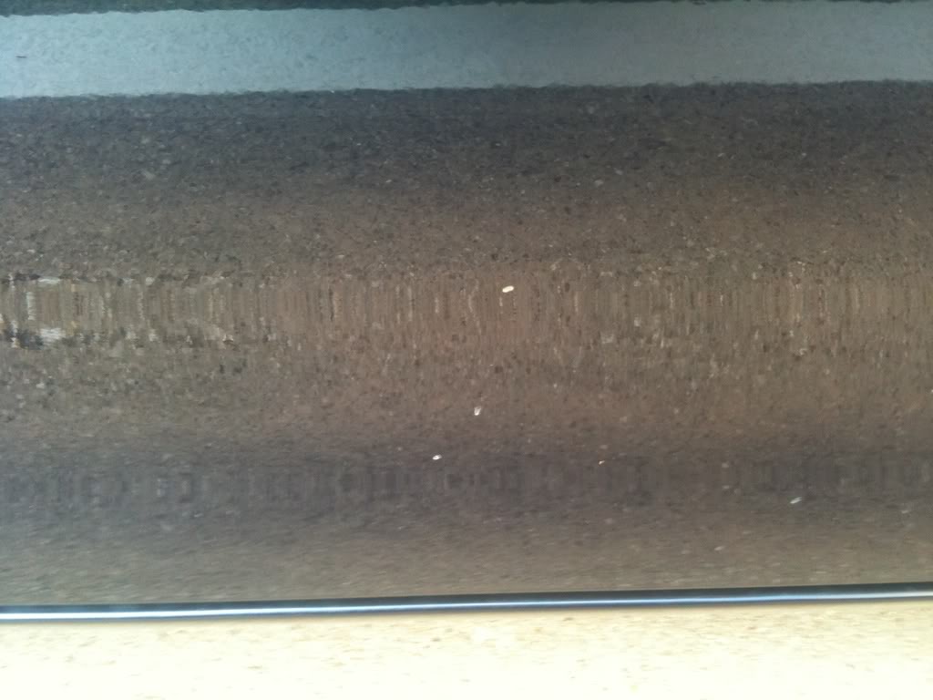

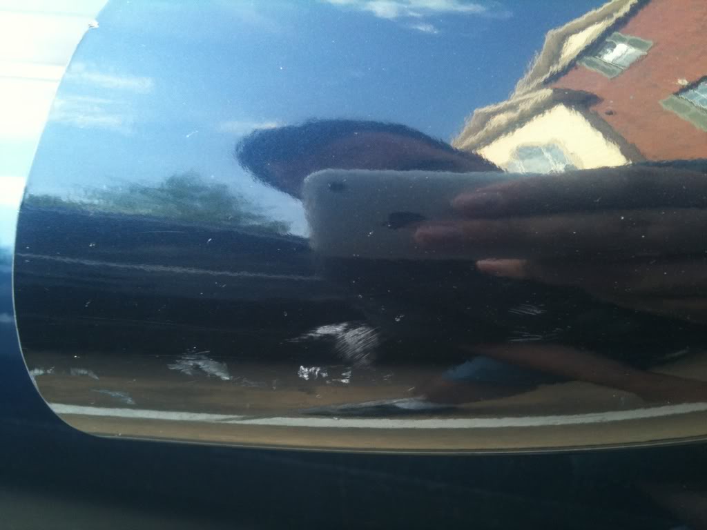

passenger door where you can see some white spots

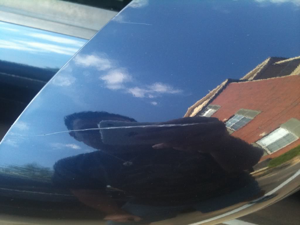

passenger mirror where it looks like someone scraped it
and then scratch on same mirror

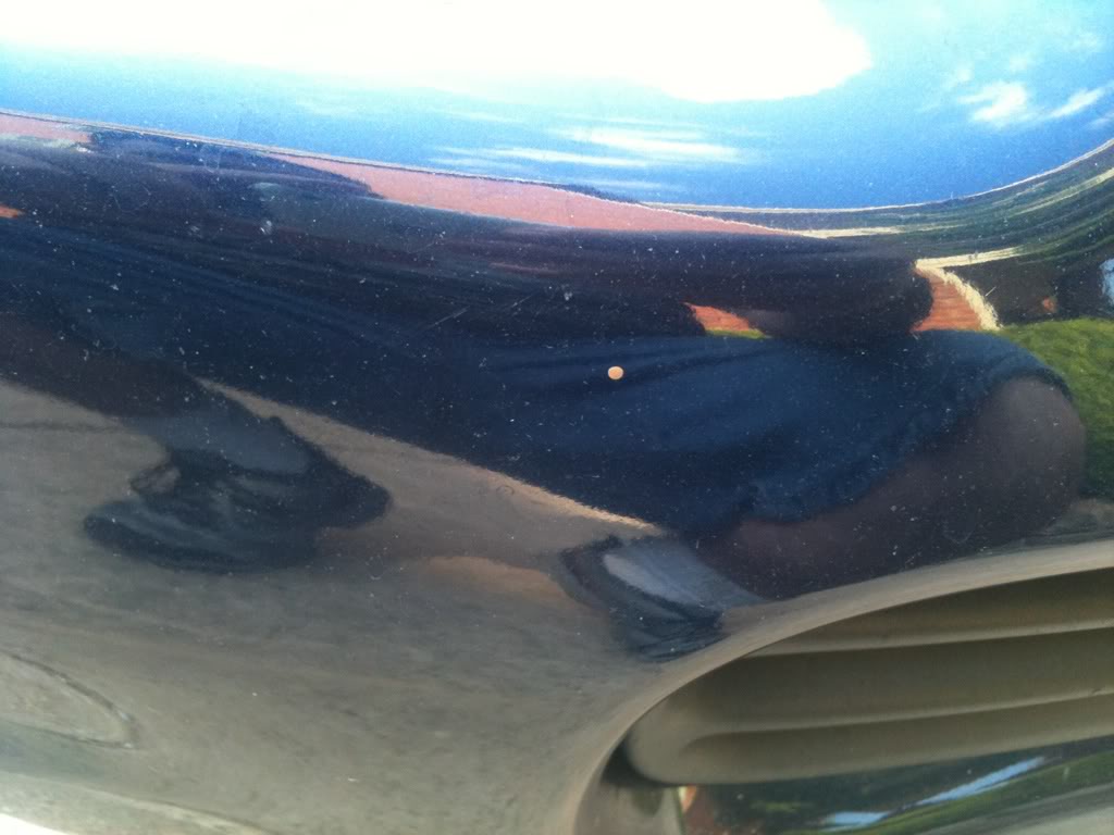

then the single beige dot on my front under the headlights.
again, all minor small things, but glaringly obvious when washing your car.
bumper
try scratch doctor and buff you heart out lol
hopefully they come out.. you can get touch up paint for the white spots but that sometimes dosen't work out too well
good luck!
good luck!
Somebody hit your bumper for sure. The paint dot is just on top of the clear coat, clay bar will take it right off. Some polishing/rubbing compound should take care of most of that scuff on the mirror. The rock chips,,,nothing you can do about that, the paint is gone.
