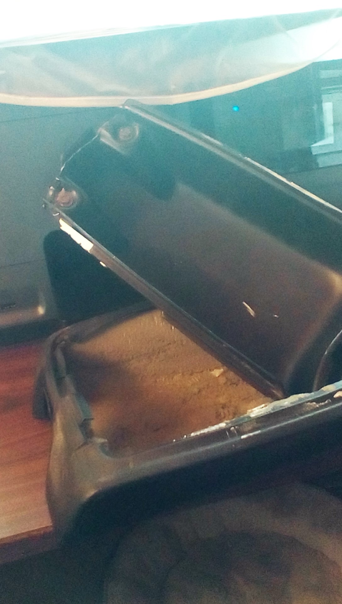

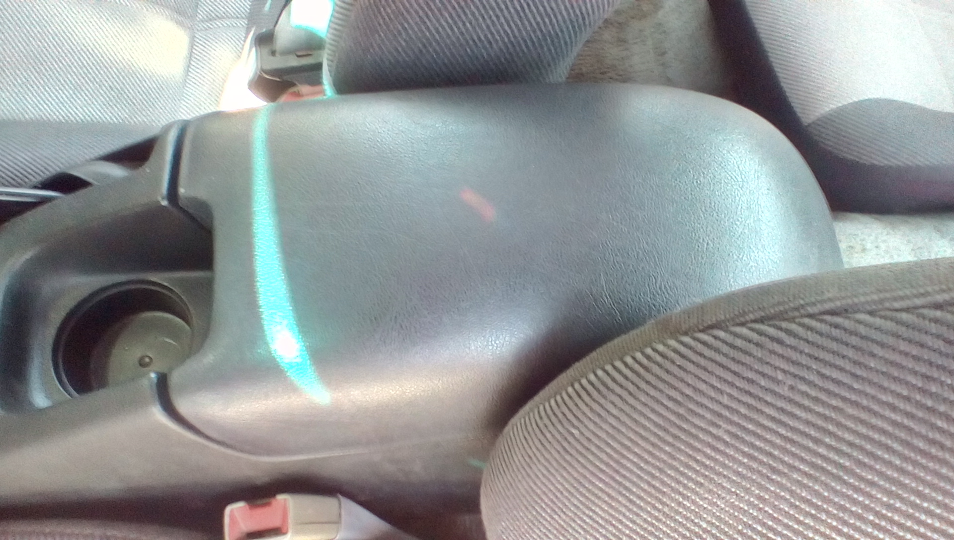

The weird thing is, the insert came out of the soft part, I took a picture. Leaning on it and opening and closing, the heat out here, all those things contributed to it's demise I suppose. Check out the pictures of it.

That's the thing.When I get into the car,the first thing I lean on is the center console(but I try not to on this car but sometimes it's inevitable ).There is a fix for them but I can't remember right now but I think it has to do with that foam stuff from Home Depot that you use on the house to fill in the gaps.Crazy glue,foam stuff,junk yard,improvise.Maybe even utube,and of course Shoebox,JakeRob,GaryDoug,and a bunch of others here but most of all Injuneer.Injuneer is the glue who holds this money saving and so informative and dead on information site together.I'm glad to be a member.Hope I don't drop the ball sometimes.Sorry for the rant.Hope this helps.

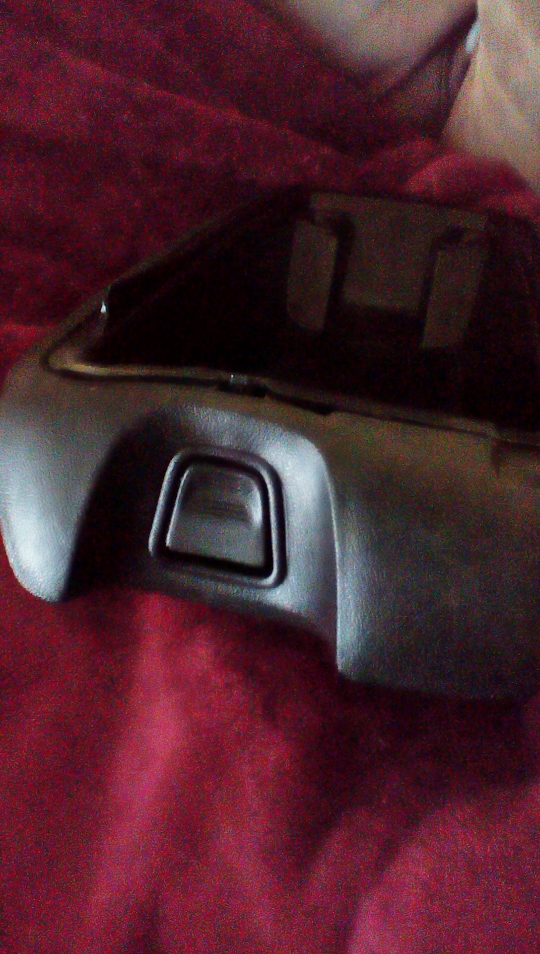

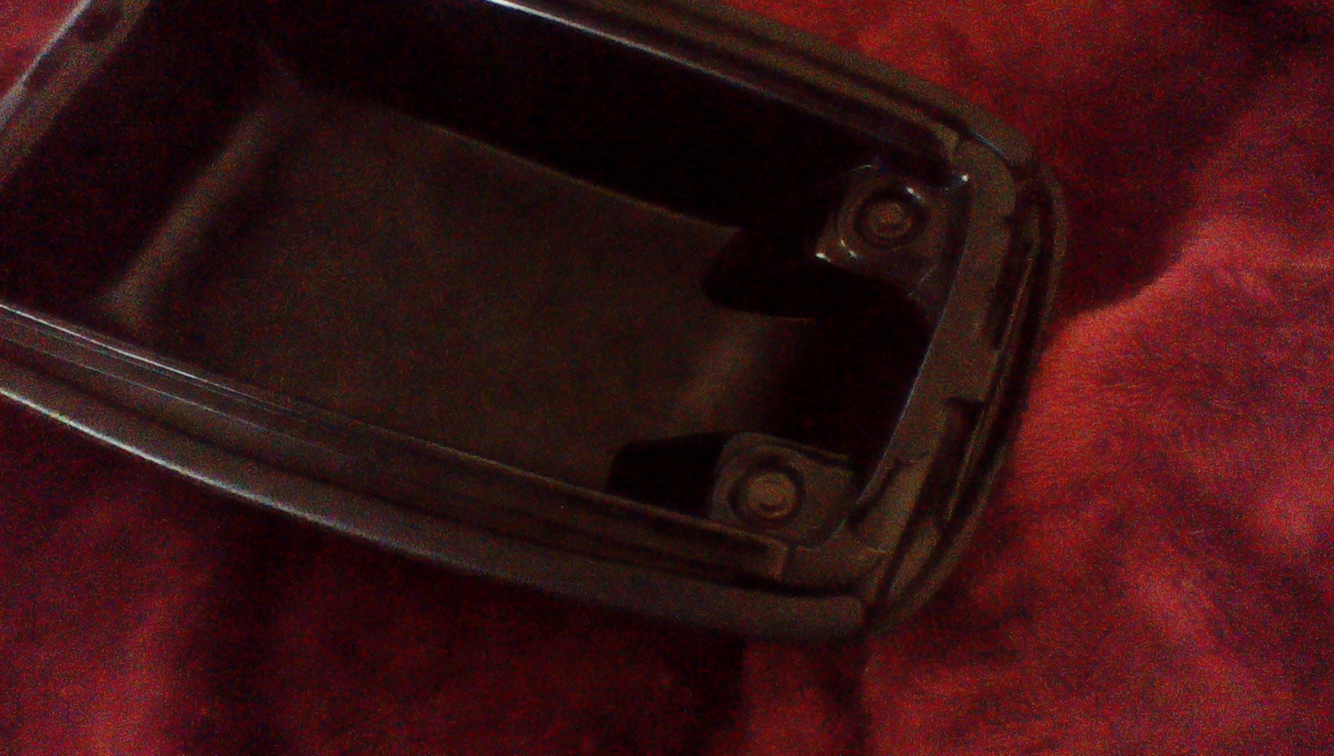

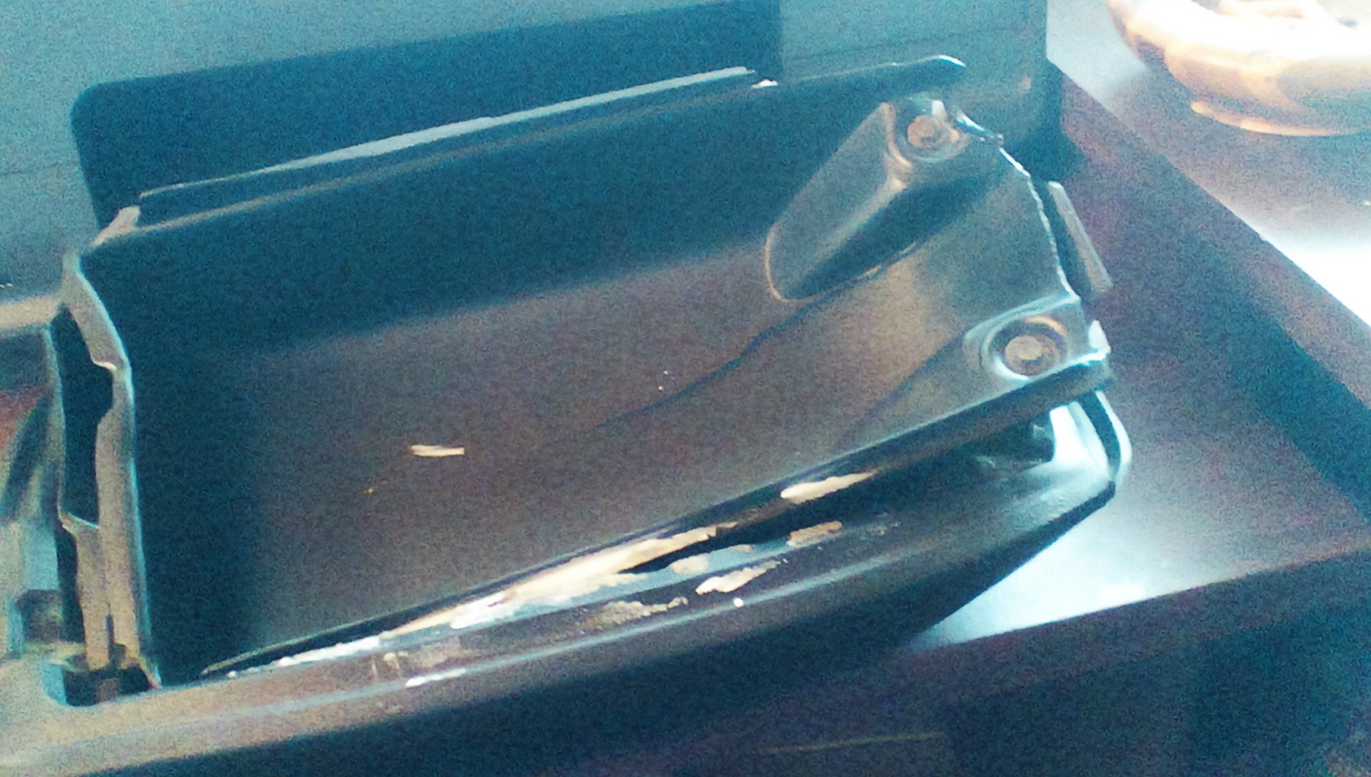

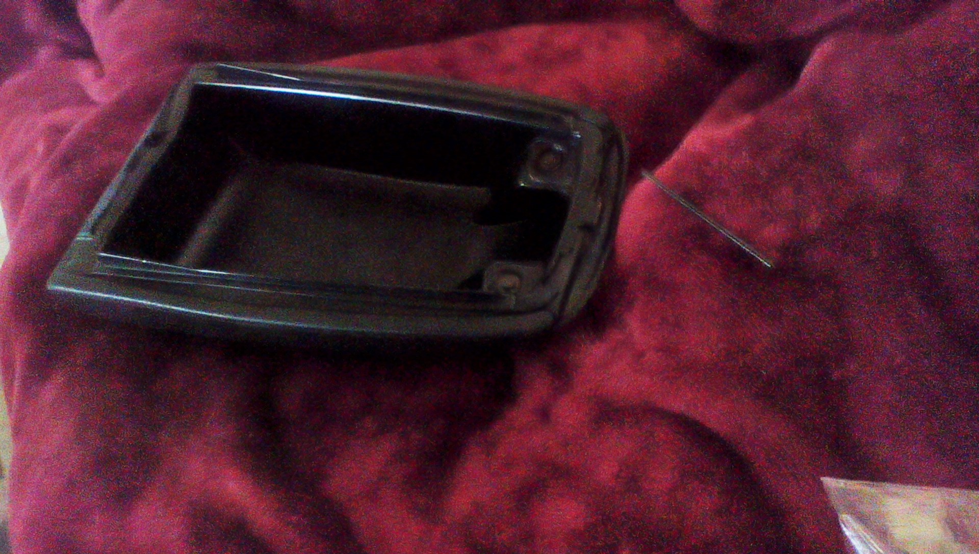

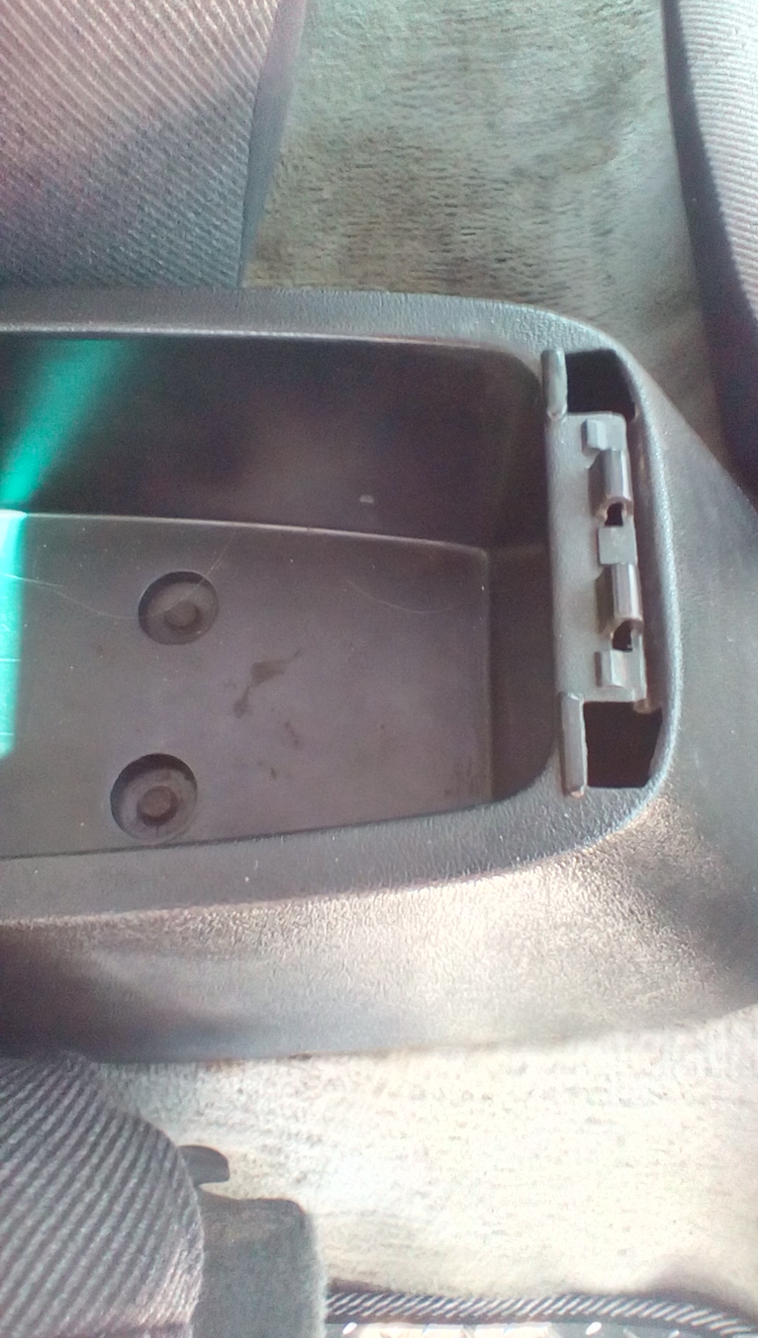

Fatdog, look what came in the mail today. It was 13.00 plus a little in shipping. The pin came with it in the box, total of about 25 dollars, give or take. I don't know if you can see it, but where the pin goes, the center piece is there, so we need to fabricate the other two pieces on either side.
The console part it goes into is in great condition, it fit right in. See pics... I'm feeling so lucky today I may glue that thing shut and put big spikes on the top of it to keep anyone from opening it or leaning on it.

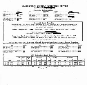

Looks Perfect.Great find.On the smog thing what I do is make sure the plugs and wires are in good shape but I always change the oil right before a smog check.And the car has to get totally warmed up so I take it on the freeway for a bit and also let the car sit at the smog place idling till it gets real hot till the fans come on.The smog sniffer likes a hot engine.What's wrong with the opti?Maybe I missed the post.Anyway,are you loosing coolant?The water pump sits on top of the distributor so when the waterpump starts to go,it shorts the opti out.Any coolant on the drive way?Hope this helps.

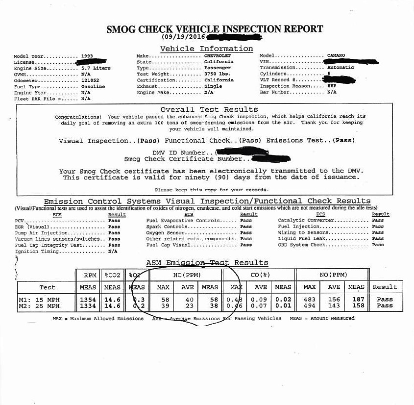

Passed smog today! A tiny bit better than last time. Whew!! Actually didn't really take any precautions, just took it down there (well I didn't, hubbie did) and it made it through one more time.
Thanks for the tips though Fatdog, I really appreciate it. Here's what you need to pass California smog, as of today. Things can change of course.
