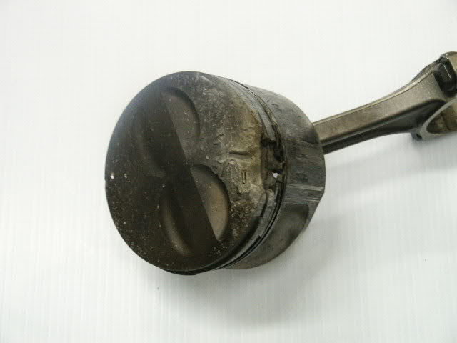

The 100 octane will probably do it for ya, but...
Stock pistons SUCK!!!
Here's mine, 100shot+no timing pull+stock pistons = ....
Though I did run this for about two years, and dozens of bottles before this happened. I had the same philosophy as you: If it breaks, time for a rebuild! So, it broke (obviously) and now there's a shiny new 383 between the fenders

Looks like you went lean?
Might have been, the bottle pressure was at the top of the limits, but still no higher than I had ever run before. I've since upgraded the fuel system, and I have a timing retard for it as well. With all the carnage, it was hard to tell if it melted, then broke pieces, or if pieces broke and then melted. It happened around mid-point during a full 1/4 mile run. The top rings were both broken in multiple places, I wondered if the top ring may have expanded enough to butt the ends together.
