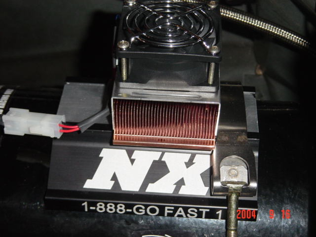

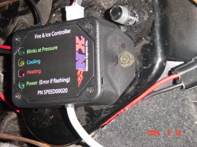

I have it. It a pimp piece, but it take awhile to heat up. Also it really takes a while to heat up or fails to heat up (error light flashes) if it is real cold outside 40 degrees or lowwer. Cools real good. Here's some pic of the set-up:
NX fire & ice bottle heater/cooler
NX fire & ice bottle heater/cooler controler
Hidden bottle
