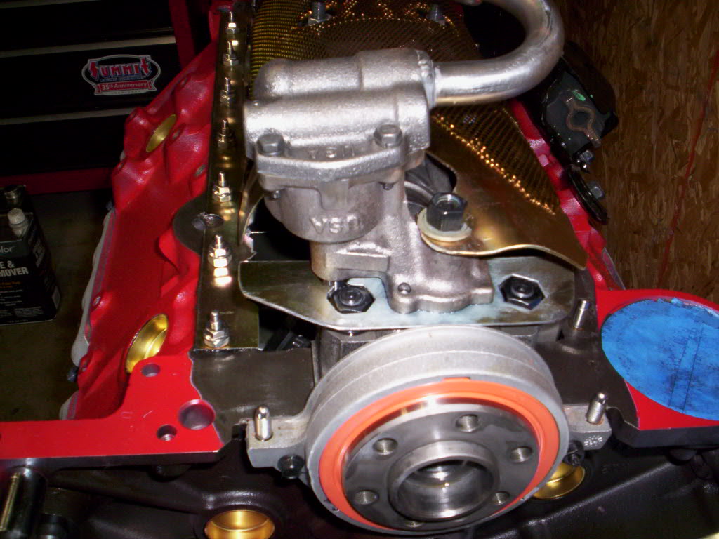

I am trying to get my OE windage tray to work with my new 383 4bolt block. I have done a few searches and found the part numbers for the 3 main cap studs from Milodon but.....
My question is :
What about the back stud that mounts to the oil pump? Does this also need to be modified?

Can I just use the original stud and some washers? Any insight here fellas?

I used a different tray, but I just bolted it down back there. As long as it doesn't hit the crank and you have about 1/8" clearance. As you can see, i probably could have used a longer stud, but I just Locktited it on there and it's been there ever since.

I was just making sure there was not another stud i needed to get from Summit. Im using my OE windage tray from my 94 Z.
