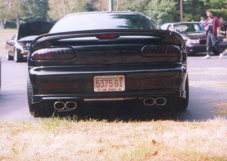

I run 315/35/17's on 11" wide Kinesis wheels out back. Fit fine with no overhang in the rear but it's all in getting the correct offset. That and perhaps lining the rear up with an adjustable panhard rod.... mine was fine though without adjusting.
Here are a few pictures. The first being a 335/35/17 setup and the others with 315's.
http://www.bfranker.badz28.com/appea...V1Enkei18a.jpg
http://www.bfranker.badz28.com/appea.../blackvfn1.jpg
http://www.bfranker.badz28.com/appea.../fiskefm5a.jpg
Courtesy of Brent Franker's website.
