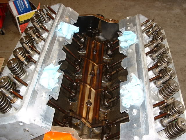

are your heads set up for SA rockers? there needs to be space for the sides of the rockers adjusting mechanism to align with on the end of the valve - for non SA rockers the retainer is almost flush with the top of the valve.
this is set up for non self-aligning rockers - if your setup looks like this than you need to get different rockers - also, Proform rockers aren't the best rockers in my opinion

I dont know if you can tell from this pic but this should tell you. Im pretty sure they are set up for sa rockers.Name:  DSCF0122.jpg
I know proform arent the best rockers but they shouldnt be bouncing off the pushrod regardless. Could improper lash adjustment cause what i am describing?
