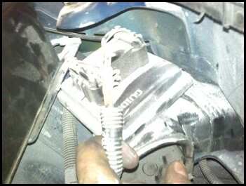

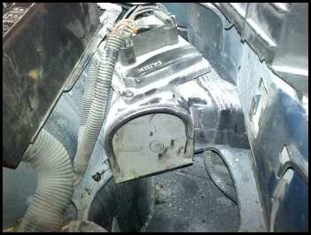

ok so ive looked on a few other 4th gens and they do not have this "thing". my car has a cold air intake on it, thats how it was when i got it. ive look at shbox.com and could not find what this is. im thinking maybe part of the stock air ducting? what is this? Name:  12.jpg

Looks like the headlight control module. Its normally bolted to the side of the stock air intake box. Shoebox doesn't have a photo because he has a Camaro. Only the Firebird has the box, for the pop-up headlights.

any place i could relocate this or hide it and its wiring for a cleaner engine bay? ive never noticed it on some of the turbo/supercharged firebirds when they run the piping in that location

I have that area filled with nitrous lines/solenoids, purge, relays for various items, so I just bolted it to the flat piece that covers the hole through the bottom sheet metal. The flat piece came with my ram air system. When I had a CAI and no nitrous stuff, it was bolted to the radiator bulkhead, and pretty much out of sight.
