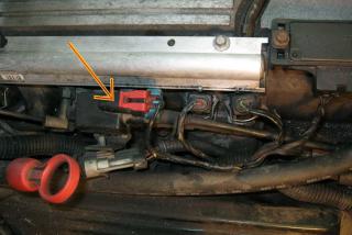

What is this air valve called/used for
Putting a 95 LT1 engine in a streetrod and stripping it down to bare essentials (have benchtop cables to program the ecm).
What is this air valves' function. Located on passenger side between injectors, 2 wire plug, 2 vacuum lines.
Thanks

Re: What is this air valve called/used for
EVAP purge solenoid. When it opens, engine vacuum from the passenger side of the throttle body pulls the hydrocarbon vapor out of the carbon canister in the driver rear fender:
http://shbox.com/1/evap_sol.jpg
Injuneer
Thanks ..you always come to the rescue!
