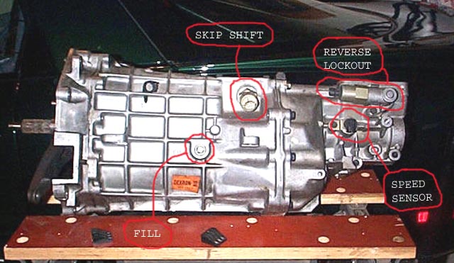

You can delete the "Skip Shift" feature by unplugging the skip shift solenoid connector on the driver's side of the transmission. It will set a code (DTC 84) but that one does not turn on the SES light and does not affect the way the engine runs. Put a 2,000 ohm resistor across the pins of the harness connector, and no code.
