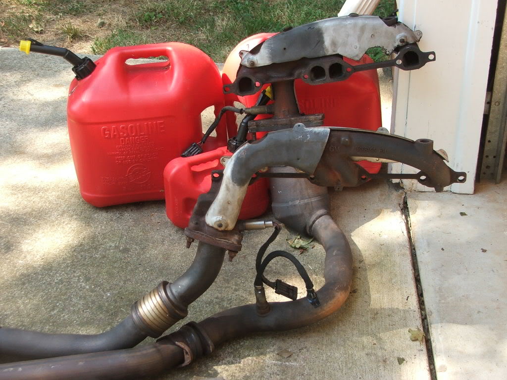

ok picked up a 7/8 from my dad. I was under the car and i am trying to find all the sensors but I only see 3. Isnt there supposed to be 4?
Theres one right under the drivers side before the cat and then theres one on the pipe after the cat. Then on the passenger side theres only one before the cat and then I dont see any other sensor.
I found these 3 like shown in the pic

If your car has just one cat, you'll have three o2 sensors. If it has two cats, you'll have 4.

My car has 1 cat and 2 o2 sensors.
