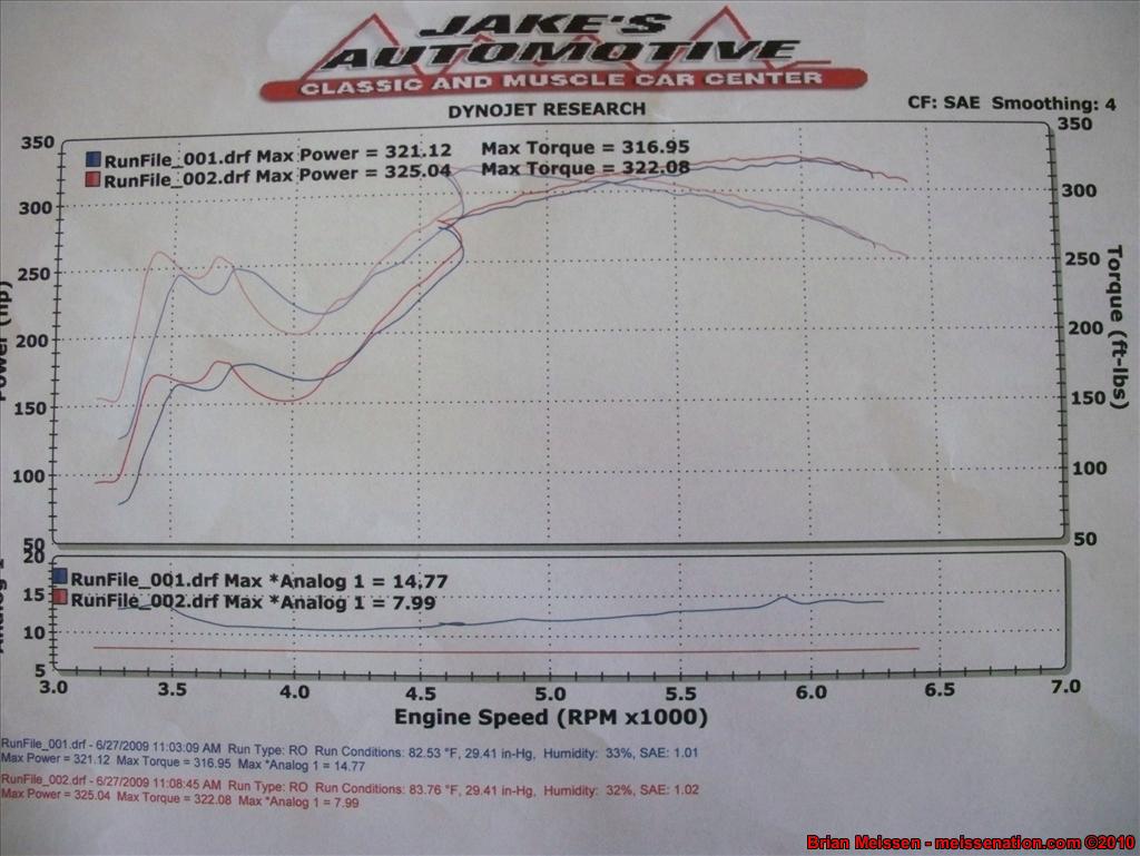

Mine didn't have a WOT tune fully done and a bad fuel pump that was going to 20psi at WOT and not giving the engine all the fuel it wanted and I had 321hp with cutout closed and 325hp with the cutout open.
A4, CC503, 1.6 pro mag roller rockers, 30# fuel injectors, ls7 lifters, 918 springs, etc, etc.
But my AFR was 14.7... (bad fuel pump) Haven't had it dynoed since the fuel pump was replaced and the tune was completely finished.
