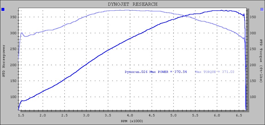

Oh, and since I've seen it become a subject of controversy in other threads, I'll point out that all the above numbers are SAE. If anybody has a dyno they want to compare that's corrected to STD conditions, here you go:
http://www.jonaadland.com/NewPics3/CamdynoSTD.JPG

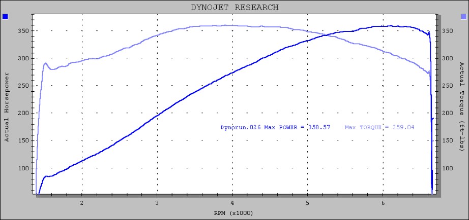

And in case anybody's curious what the car actually put down:
http://www.jonaadland.com/NewPics3/CamdynoActual.JPG

Wow on the STD numbers, 370rwhp and 371rwTQ

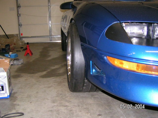

In all seriousness, I haven't been drag racing in a long time...sort of lost interest in it. However, I am curious what kind of trap speeds I could turn so if all the the other work on the car falls into line and I have some extra time, I wouldn't rule out making one trip to the strip. But don't hold your breath. If I do, I'll be on street tires and with the roadracing suspension the car won't launch worth a crap. Traction? This is my idea of traction:
http://www.jonaadland.com/NewPics3/315FrontTest.JPG

I like that. Put the tire where the work is being done.
I hope your new-found power gets you a PAX win!
Did Bret tell you he used to auto-x his GTI? A few PAX's. Fun to watch that V-dub 3-wheel almost every corner with little black clouds of street rubber around the 3 tires touching the ground.

Yeah, at the track I always go through front tires faster than the rears. Err, well, at least I used too....
