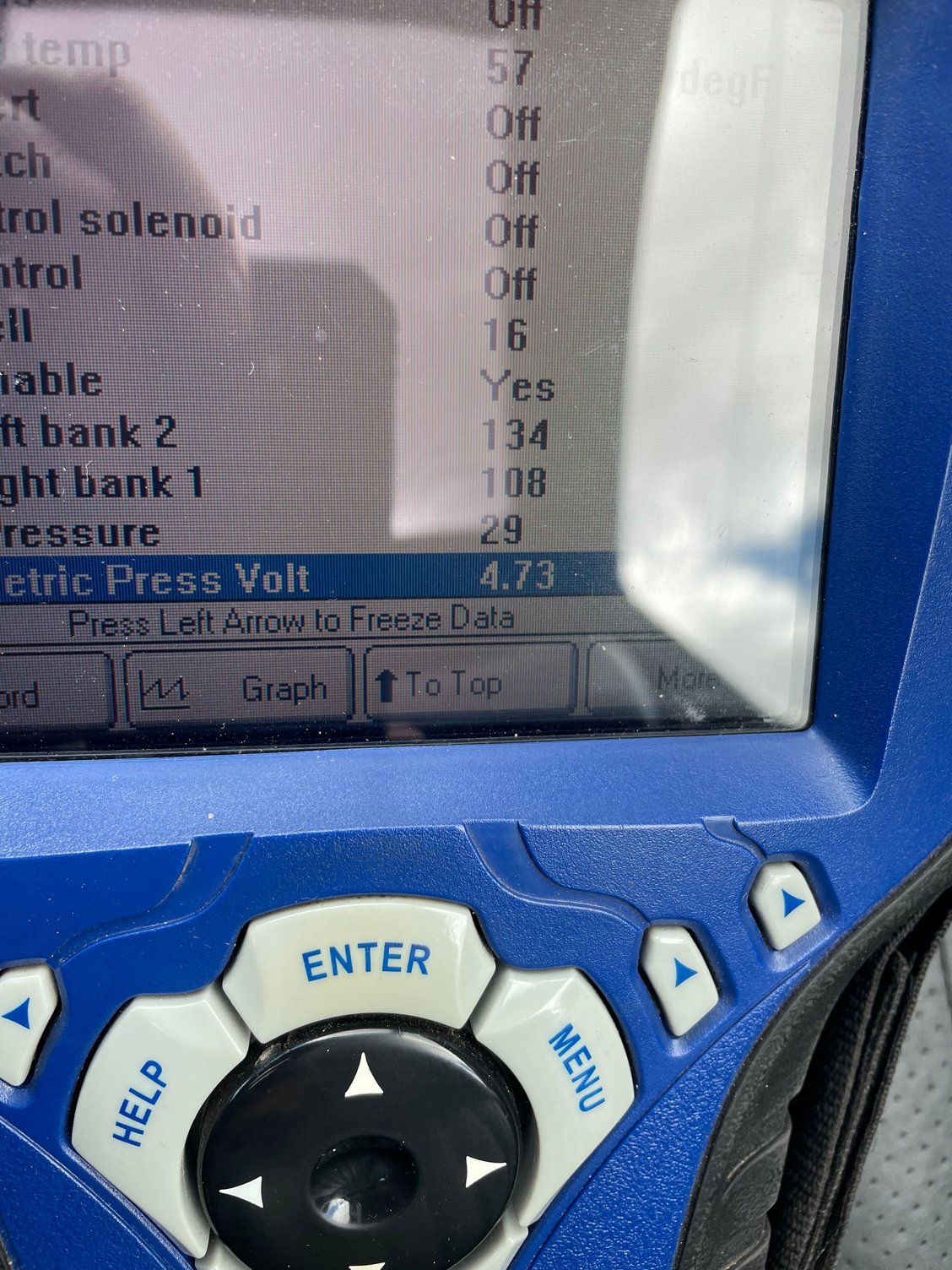

Here are some pics from the Genisys screen. First is at idle fully warmed up, next is at steady cruise closed loop, then idle again.

Let's talk about IDLE first.
It's in the idle cell (16) in first and third photos. At idle, there is a problem with one bank of the engine pulling out 15.6% (108 LTFT/BLM) of the fuel it would normally supply. But Bank 1 is not the RIGHT bank. Bank 1 is left bank, driver side, cyls 1/3/5/7.
Was the bottom photo take later, after driving for a while? The one bank has gone totally normal (128) and the other bank is still seriously screwed up (108).
Why did one of those numbers change? We might know more about what happened if we had a data log, showing thousands of lines of data, taken a fraction of a second apart. Then there's the possibility that the PCM has to pull even more fuel out, but we can't see the short term fuel trims (STFT = INT). A log would have those numbers side by side.
Then there is Cell 6,
That cell means the engine was operating in the range of 1,200-2,000 RPM, with a moderate engine load (MAP in the range of 30-50kPa)
In Cell 6 the situation hasn't changed much. One side is OK (slightly high) at 130 (adding 1.6% - within normal tolerance), other bank (we still don't know which, but your Tech 1 seems to have the banks correct)
Other:
PCM is in closed loop. MAP sensor appears to have set a rational barometric pressure in the PCM.
So.... why does the PCM have to subtract all this fuel from the amount it would normally supply? Could be a faulty O2 sensor (but we can't see the O2 sensor readings), Or leaking injector(s) on the mystery bank. Or... if "Bank 1 Right" really is the right bank, could be a leak in the fuel pressure regulator. Did you follow up wth my suggestion that you check for fuel in the fuel pressure regulator vacuum line, in post #7?
Other:
Yes, pulled the vacuum line off the regulator and using a hand vacuum pump, applied 10” of vacuum. Let it sit for a few minutes. No leak down, no fuel in the line. I also checked the impedance of all 8 injectors, all within spec at 12.7-13 ohms. Using the OTC Genisys, I can see the numbers are off in every fuel cell that I could observe. All are skewed the same, with one bank good and the other rich. I would say this is trending toward a leaking injector(s).
Yes, the bottom pic of the idle was taken after the steady cruise state for a few miles.
