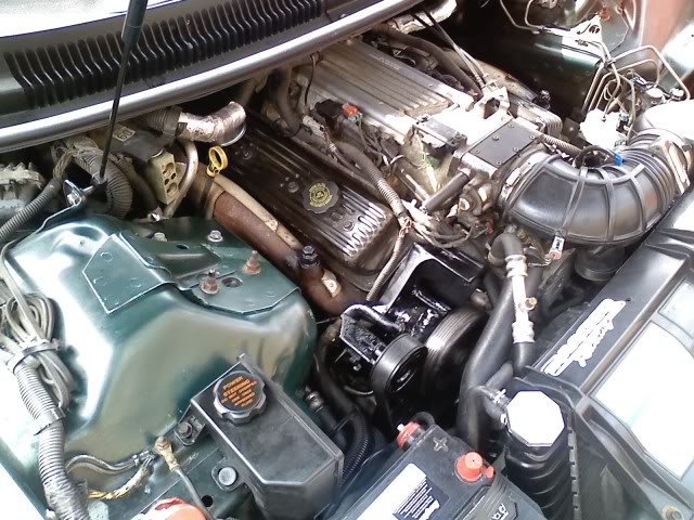

no a/c delete pulley, i have an alternator relocation bracket.
i have a 57.7" belt on it at the moment, it was really tight going on. Started the car up, no noise, sounded good. So parked car, next day get up for work and its squealing. getting to the point where i want to change my set-up again. the 58.5" is to big, couldnt find a 58"
GTR-4060585 - 58.5"
GTR-4060578 - 57.7"
GTR-4060575 - 57.5"
