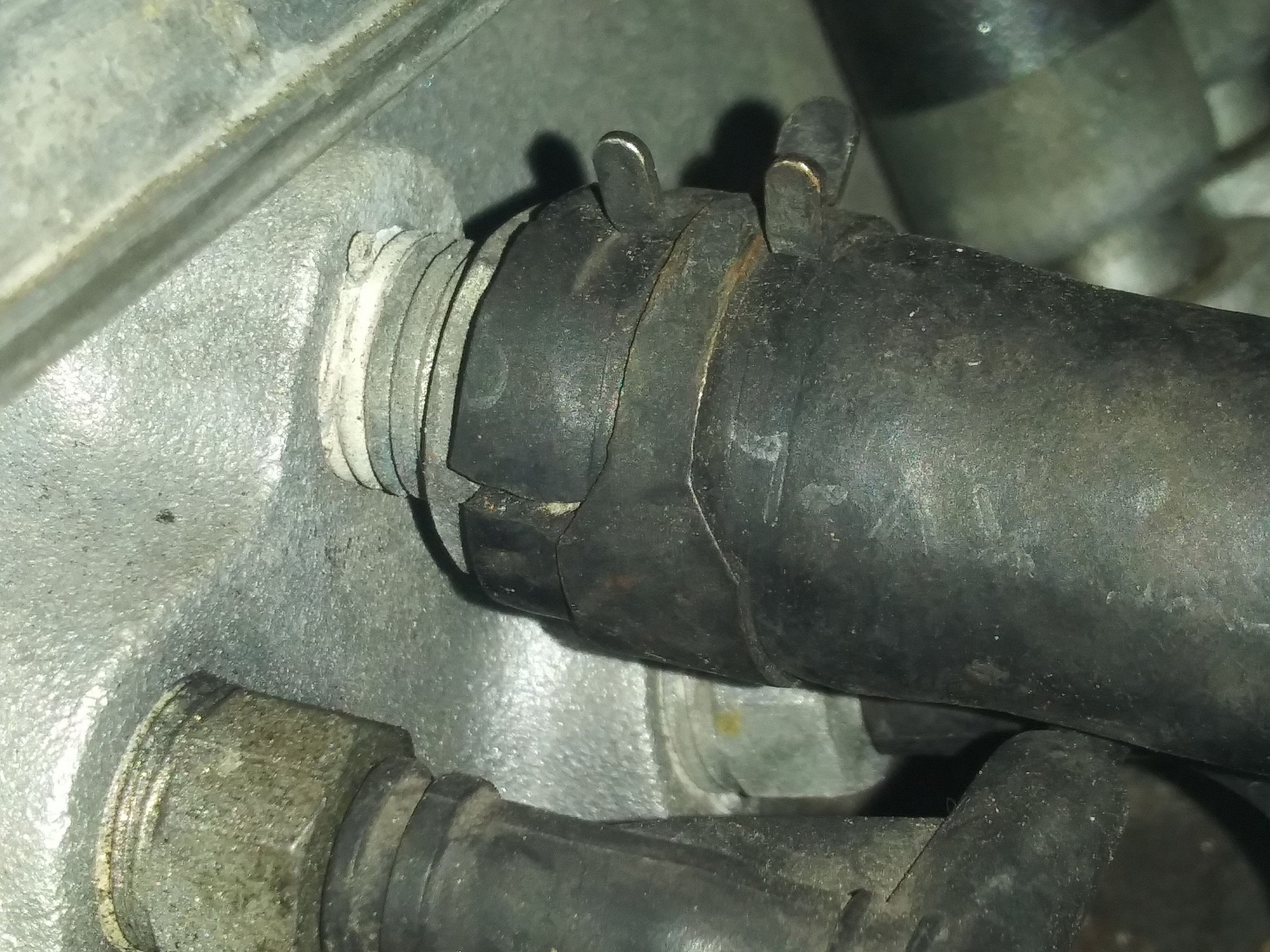

Also another thing that brings to my attention is all of these symptoms are worst when it's really cold outside.
And as my car gets warmer it runs better.
Which remind me of a thread not to long ago i read about the ECT sensor causing lean and rich conditions.
Doesn't the pcm need the ECT sensor to function properly in order to achieve close loop?
I've notice over the pass weeks while situating this lean condition problem that it is hard for my car to re-enter close loop after extended drives when restarting the engine.
There no overheating, or coolant leaks that I'm aware of.
But I do know a bad ect sensor can cause a lot of problems.

The PCM needs a minimum coolant temp to go into closed loop, along with hot/active (at least 600-degF) O2 sensors, and a time since start, usually 206-seconds.. ECT required can vary anywhere from 120-140-degF. There's no code for a faulty ECT sensor unless it basically totally fails, resulting in an open circuit or a shorted circuit. The temps being "off" and inaccurate will not set a code. But it can cause the PCM to think the engine is cold, and richen the target A/F ratio.
I think you need to download Scan9495, buy or make a cable, and run a data log of the PCM under the conditons you are describing. It's a lot easier for me to look at the actual data than to look at bits and pieces in a post.
