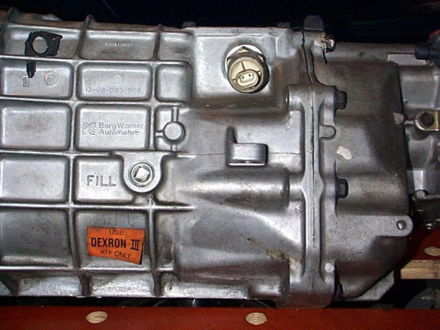

I also owned the original T56 out of George Baxter's record setting 1997 30th SS convertible. That trans was also a Borg-Warner (see photo below), and the orange sticker now read "Use Dexron III ATF Only". The trans was out of my sight once, when a member here got stuck in Colorado with a T56 failure, and we shipped my T56 to him so he could drive back to the east coast. Then another friend wanted to borrow it to see if his original T56 had a bent output shaft, causing some strange vibrations. When we installed it in his car he insisted on using some Honda ATF, that was supposed to be some sort of miracle fluid for the T56. He drove with it for 3 weeks, and when he gave it back, he told me it was making strange noises. Have no way of knowing if it failed do to something in the way it was used by two other people, or if the Honda ATF was the thing that did the damage. I eventually sold it at a reduced price, making the buyer aware it was "making noises". He had it rebuilt.
Borg-Warner sold the complete T56 design and production line to Tremec around 1997/98, and the facilities were moved to Mexico. I believe that while the trans cases said "Tremec", the tailshaft housings still said "Borg-Warner". It was sometime around here that the blocker ring problem was addressed. The B-W design used "solid paper backers" for the blocker rings. Tremec at some point started using "fiber" backers.... not sure if it was "fiber" or "carbon fiber".
In any case, I tend to respect the input of the engineers that design a part, particularly when overall, it is a very reliable and successful product. Even as a degreed, and licensed professional engineer (mechanical), I'm not going to second guess them without a thorough technical investigation. If it ain't broke, don't fix it.

Thanks, Injuneer, that's very informative. The reason I asked was not to challenge the engineers but to clarify the timeline in my mind. I work for a paper company that was a supplier to BW through the 80's up to 1996. They cancelled the contract right about the time of the sale to Tremec. We were not able to secure the contract with Tremec due to our pricing being too high...
Probably not a cause of any synchro problems with later transmissions but interesting (to me..)
