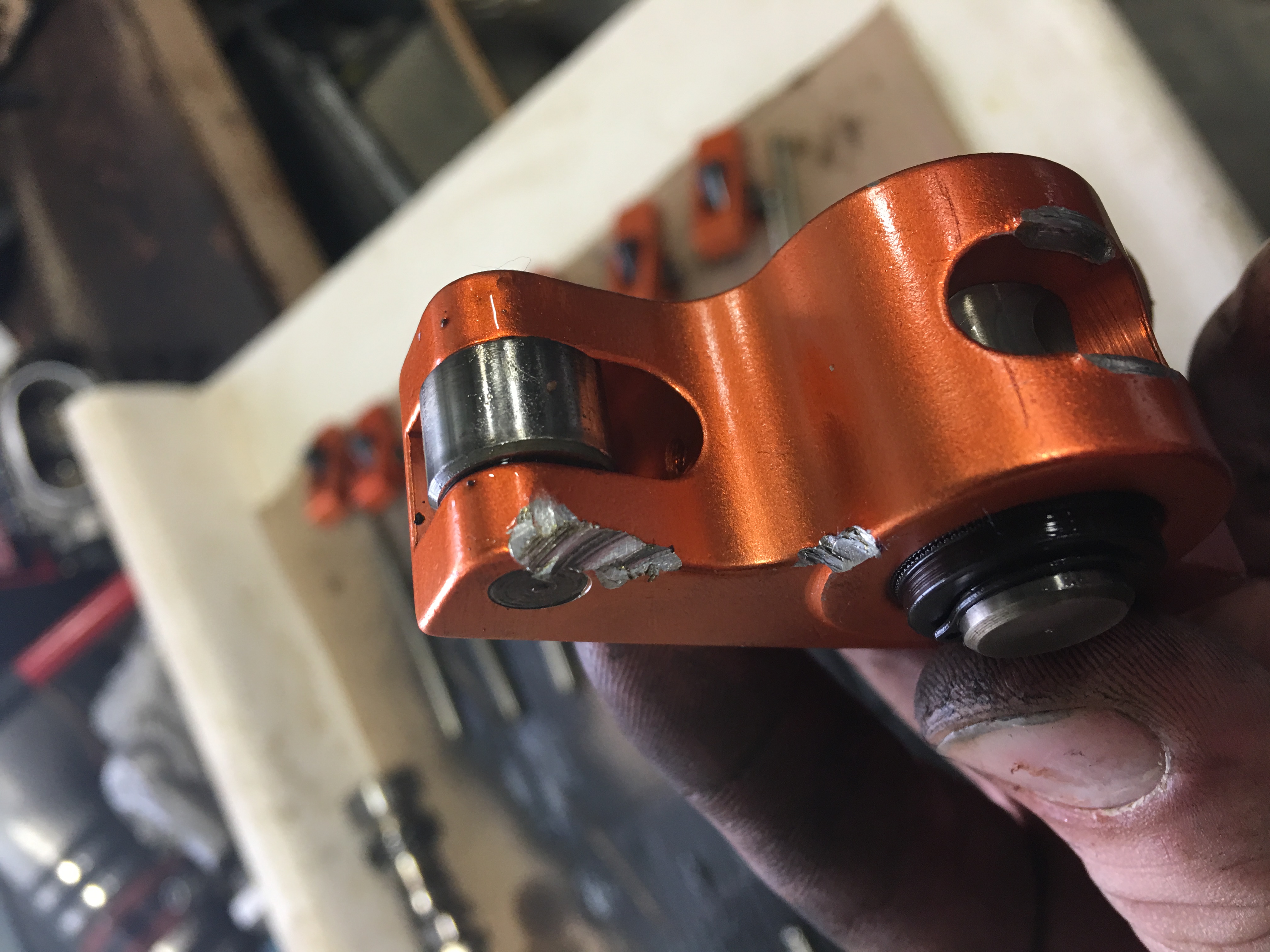

They are stock untrimmed valve covers, I don't know if these are even guide plates or not, but the pushrods are not held firmly, I'm wondering if they are the plates gm uses for installation, I will get a picture of those later. But here is the rocker. Only 3 other rockers look this way, this is from cylinder 1.

The Crane Gold "narrow Body" RR are the only ones I know of that do not require VC baffle trimming. I don't know by your pic what brand RR you have
you say you don't know if you have guide plates.....well you have NSA (non self aligning) RR so you need them. Otherwise the RR will walk around and can come right off the valve stem tip.
take a pic of your cylinder head with the VC off. we should be able to see if you have guide plates. They are not a stock item as these engines came with SA rockers
are there signs of scraping on your VC baffles and or your valve spring retainers
and the metal debris from the RR is in your engine...not good

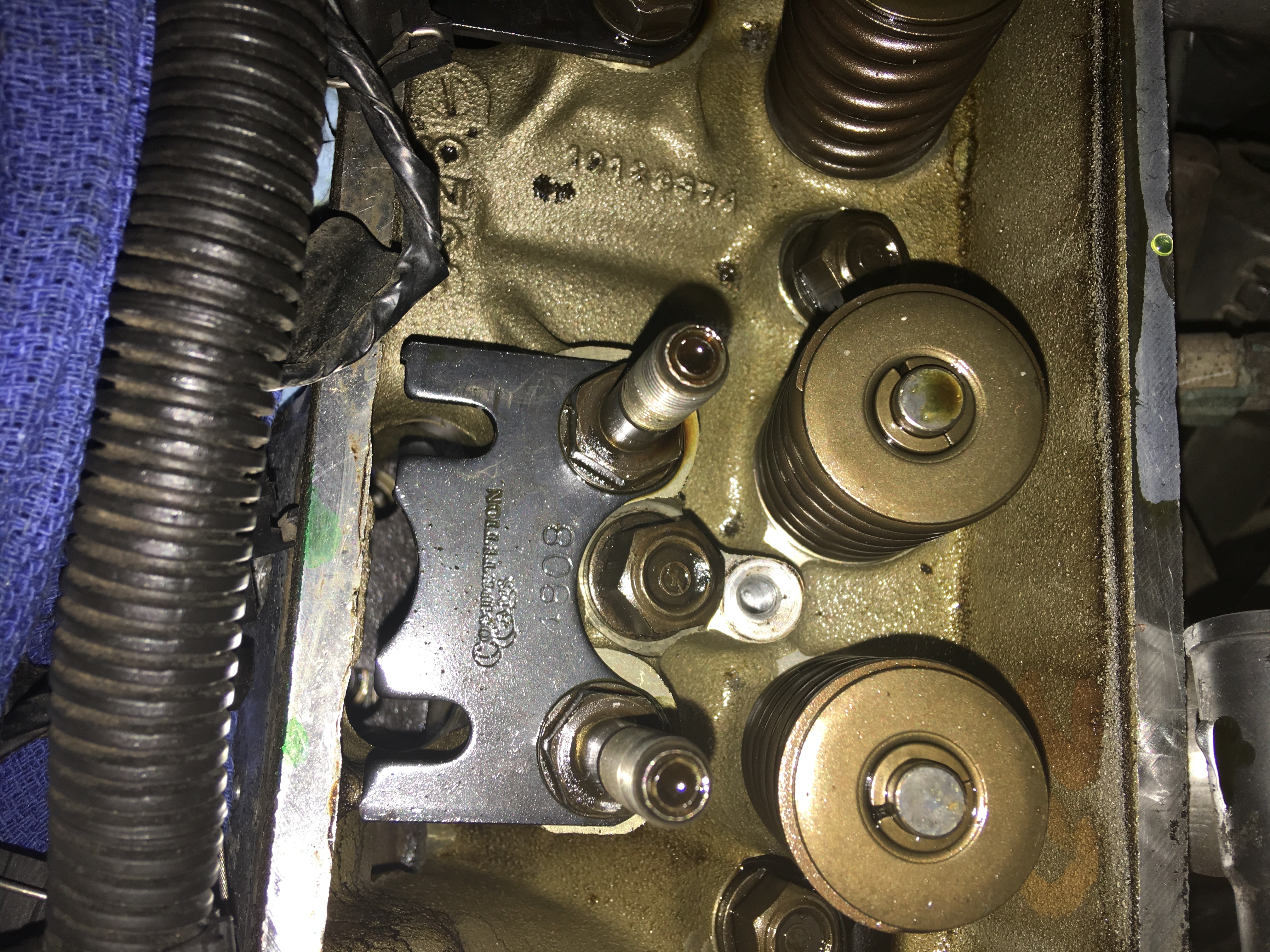

This is the only pic I have at the moment. I will try to get another one without rockers tonight, but you can see the plates I am talking about
Old Feb 22, 2016 | 02:51 PM
Chimera96's Avatar
Joined: Jun 2003
Posts: 1,114
Re: rocker arm help
I see guide plates....your "geometry" in terms of push rod length and the alignment of the guide plates may not be right.
Hard to see in the pic but is there signs of contact on the edges of the retainers?
I use the ISKY adjustable guide plates vs one piece. I found they allowed me to align the RR dead nuts L to R placement on the valve stem tip.
your sig says CC 918 "dual" valve springs. 918 are beehive single springs. Your pic does not look like bee hive springs
the damage to RR suggests it is contacting the retainer. You need to confirm PR length and geometry

well maybe the PO did put in RR that had the damage. If you can't see any signs opposite of where there is contact evidence on the RR to the corresponding part of the valve train than that may be the case
what can happen when PR are to short is the body of RR can hit the retainer. Your 7.200" ones on a stock motor heads & cam without any block or head decking should be spot on
Usually the one piece guide plates have slotted holes allowing some L-R positioning. Obviously a one piece won't allow you to set each valve individually so you want the roller part of the RR as dead nuts centered L-R on the valve tip then tighten the RR studs. Just look at how they align with the valve tip. The LT1 heads are different than SBC gen 1&2 so regular GM guide plates don't line up exactly on some which is why I and others use the ISKYS. If all your rollers are sitting center L-R on the valve tip you are good. If some are not and actually partially off the tip...you want to consider adjustable. I believe there is also another type (COMP??) that are individual to each valve
the 918 springs have a smaller retainer and should give you more clearance than the standard size spring/retainer shown in the pic
while a scrape or something on the side body of the RR would not be a big issue the one you show is gauged into the roller shaft itself so I would be hesitant in using at least that one. You are seeing it 1st hand so make the judgment if the RR is compromised structurally

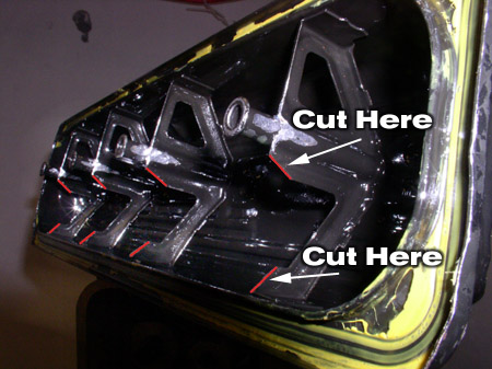

courtesy of Golen Engine Service
cut on the intake manifold side of VC

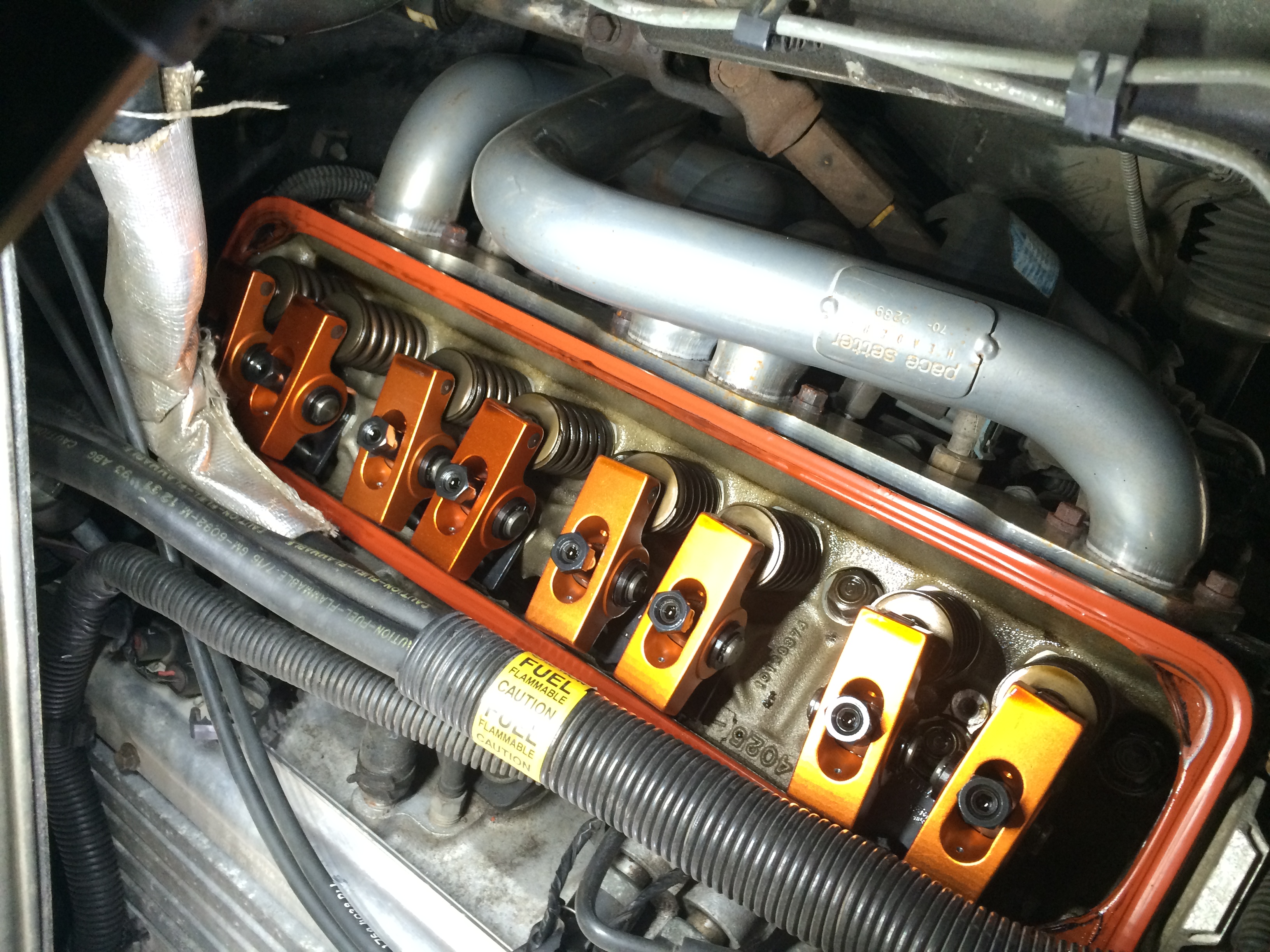

Re: rocker arm help
Here is cylinder 1, where the damaged rocker came from.
Old Feb 23, 2016 | 06:04 PM
dg8srt's Avatar
Joined: May 2010
Posts: 26
Re: rocker arm help
I wonder what rockers these are then, because my valve covers are not trimmed at all.
